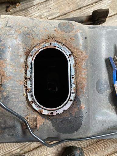

Depending where you live the sealing surface on the gas tank rusts and causes the dreaded EVAP codes.
So if you can’t find anything wrong that would be the last most PITA step in your journey.

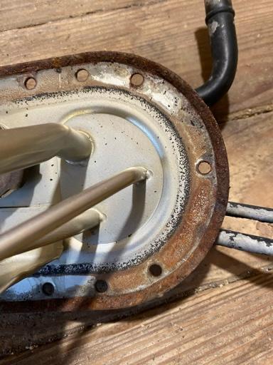

I am also curious if this is my issue…
I dropped the gas tank to change the check valve and my fuel sending unit cover did look a little crusty underneath.
Did you replace the whole unit and if so, did it come with a new gasket or did you have to buy that separately?
I cleaned up the sealing surfaces and bought new gaskets.
