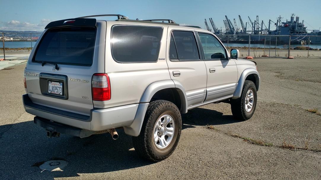

On my 00' Limited
i think parts and labor was around $400 for the tundra calipers and rotors.
