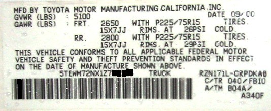

i have the same code A340F
A340F denotes the type of transmission in your rig. The "F" is the tail stock length denoting 4wd model with a xfer case .
Finding gear ratio's from documentation is a real pain with these trucks as I have looked quite a bit for a new diff and never got/found a definitive answer.
If you can, lift up the back end so 1 wheel is off the ground, rotate the tire 1 complete revolution and count the number of times the drive shaft rotates.
It will be tricky to determine if the drive shaft has turned 4.1 or 4.3 times but if you can determine with any accuracy, this should give you the actual ratio.
A 4.25 ratio should give you exactly 4 1/4 turns on the drive shaft so slightly over 4 1/4 turns will probably be a 4:30 ratio.
Where it says A/TM: Letter number number letter.
The second from the bottom on the right side.
Mine was A03A.
7.5" ring gear, 4.10 gear ratio, and 2 pinion open.
Yep, that is what it says on mine too A03A... Wanna sell your front diff? lol
