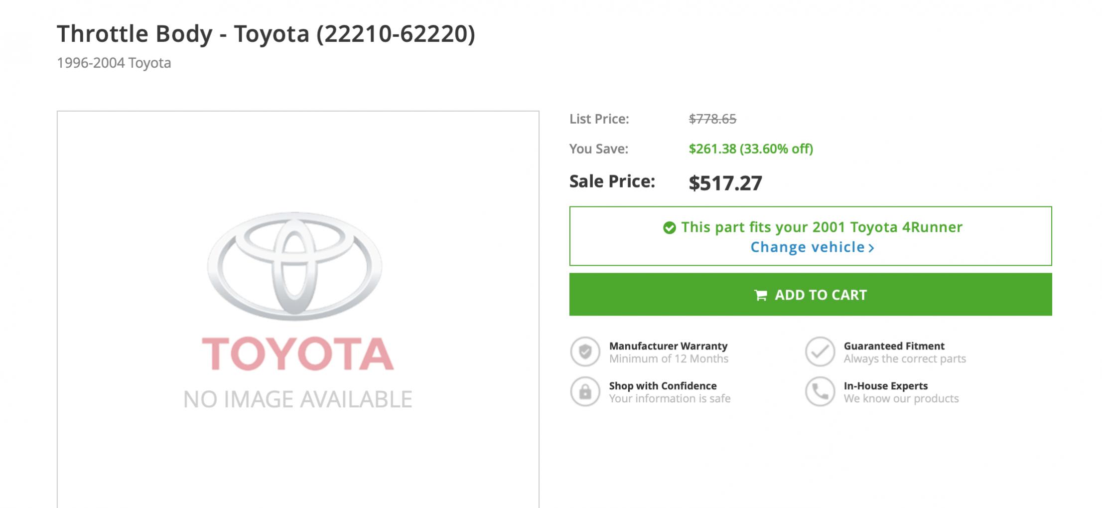

Hmmmm.... Oddly enough when I entered in my VIN on toyota parts, it looks like I can get one for $517.... Not too bad, I wonder if the sensors are included with this? Anybody know?

[MENTION=142255]duke808[/MENTION] Do you have cruise control? When I look up that part number on here: Throttle Body - Toyota (22210-62220) | Toyota Parts it says it doesn't have cruise control. I have a 2000 which is a different throttle body than 2001 and newer. If it's any help you can expand your used part search to tacoma's of the same year.
Edit: When I look it up on this page: Throttle Body for 2001 Toyota 4Runner | Toyota Parts it says it's for cruise control with the same part number so I guess you're good. I'm pretty sure it comes complete with sensors since you cannot get the sensors separate.
Yeah I have cruise. I’m going to call that dealer today and double check. I’ll probably order that instead of take my chances with eBay...
