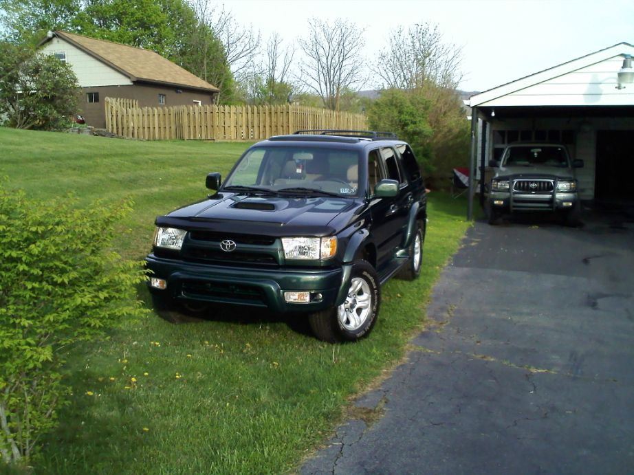

Op, beautiful truck!! And only 58k? Wow!
