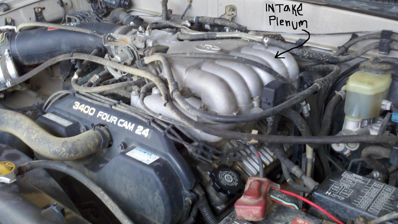

Actually you do need to remove the entire intake. It comes off in two pieces and there are two gaskets involved; one where the two pieces meet and one where the lower piece meets the engine block. When I did mine I removed my air intake as well but I don't know if its absolutely necessary...couldn't hurt and its only a few bolts.
Okay now I am confused again. Seems like there are conflicting stories on whether the intake manifold needs to be removed to get at the driverside valve cover. Anyone else have a thought or experience with this?
Sorry for the confusion. Let me see if I can find the TIS image cause I think the confusion is coming from what we're calling the parts. If I can't find that image I'll take one of my engine and mark the parts I'm talking about.
I know I need lessons in picture editing, but this is the part that comes off in two pieces, requires two identical gaskets and is necessary to remove in order to get to the drivers side valve cover bolts. I thought it was called the intake manifold, but looks like it might be known as the intake plenum. Does that help?
Alright Fonerunner, this makes sense now. Thanks for the picture and clarification. This is good news for me. Thanks for the help. Gonna try to tackle it next week, just wanted get the right gaskets.

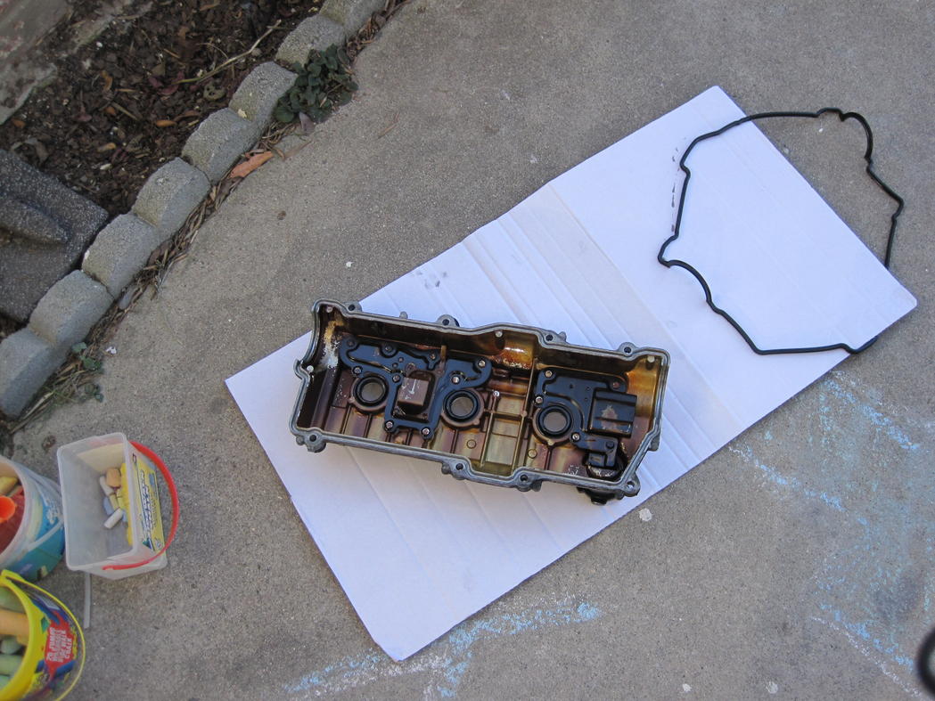

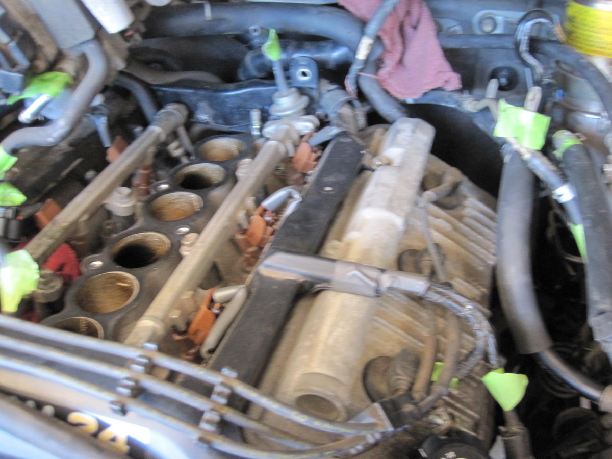

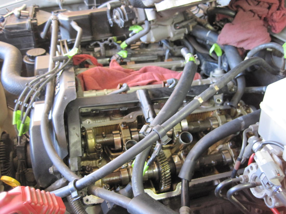

Thanks guys for your imput. I replaced the driverside cylinder gasket, spark plug gaskets, rubber pieces on valve cover bolts and plenum gaskets. Cost about $100. Now I have no leaks. Stoked.
