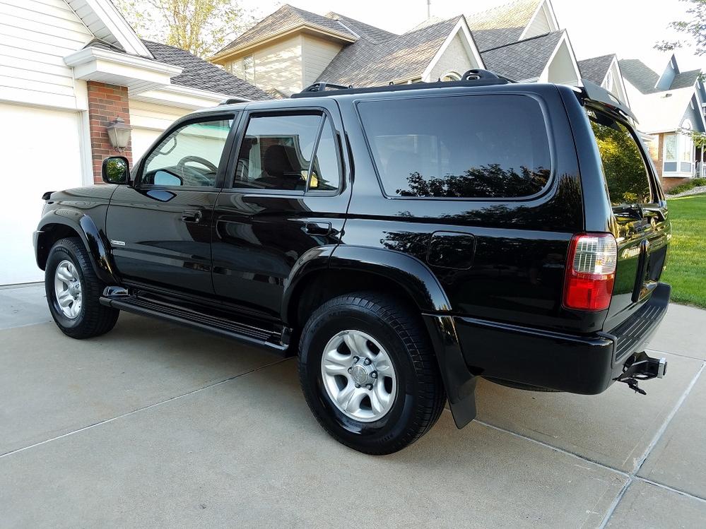

Considering the condition of this 4Runner it should not have these issues. It is spotless inside out and underneath. It's not a beater. It's actually in amazing shape for a stock 16 year old rig.

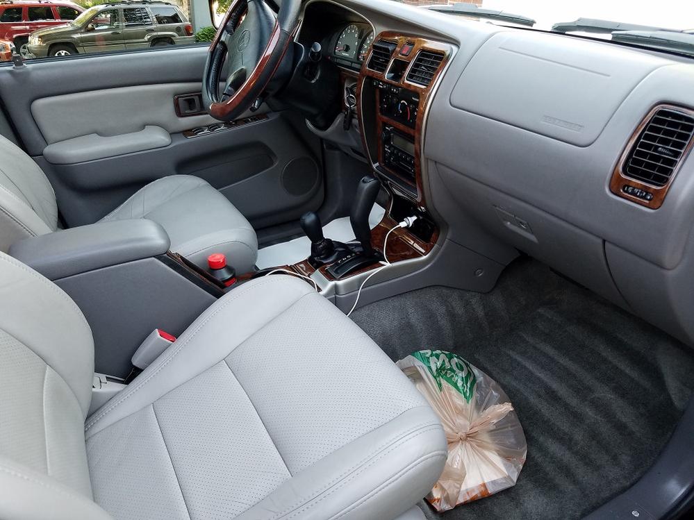

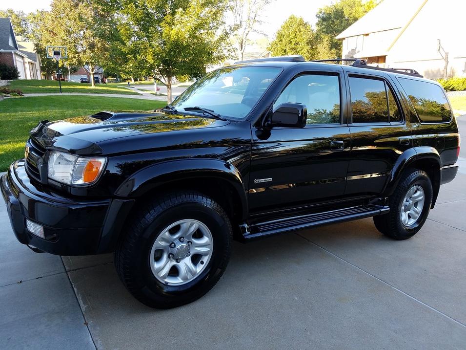

Sport edition but without fabric sport edition seats and the god awful wood trim limited dash trim.
Frankencar?

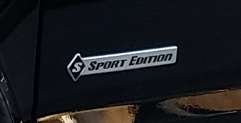

Sport Edition is the badge on the side. Told it was a Sport Limited

Yeah, saw the badges and the hood scoop. It's a lot like mine, but I didn't know they came with leather seats or wood trim. Learn something new every day. It sure is a sharp 4Runner!
Yeah! I found it and should have bought it but I offered it up to him first since he had been looking and I was not in the market. However; he only paid $7000for it with 101,000 miles and not a spec of rust anywhere,... so I would have bought it if he didn't.
Frankencar?
Leather seats were optional. The dash has the sport silver with an aftermarket wood trim kit over the top (check out by the auto shifter). Not a frankencar - looks near perfect!

I know that people have said the sport hoods create some wind noise. But it’s usually more of a whistle. If the door seals were replaced maybe they could be the cause. Have you checked them all around to be sure they are seated properly?
Edit: I just saw that you actually said “whistle” in your last post. So I’m wondering if it’s the hood scoop

The wood trim is obviously over the silver.. look at the shifter bezel. Also, those are sport leather seats. Optional on the sports, they're gray and perforated and more supportive than Limited seats. Nice rig.
