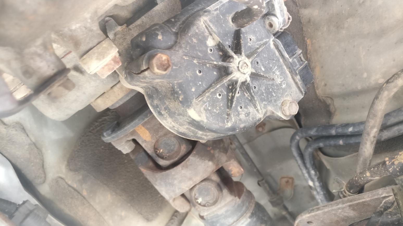

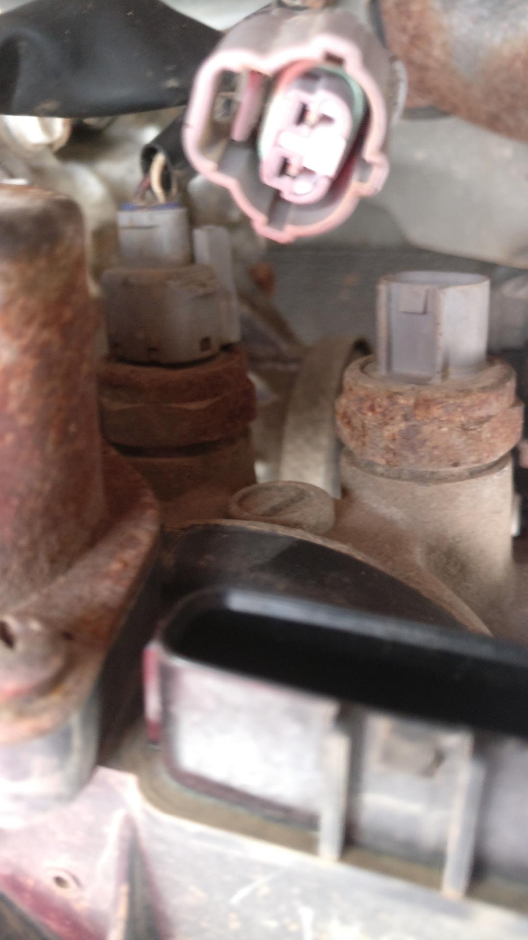

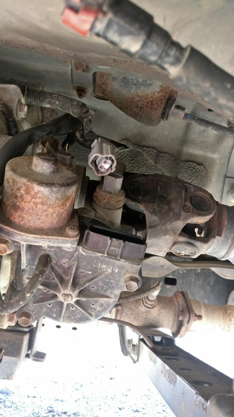

Also I had a chance to get under the truck today and look around. I was able to find the detection switches on the transfer case. I'll attach some pictures here:
Also this last picture shows something concerning. This is the actuator on the t-case. There's a crack as you can see along one of the bolts. Can't say how long its been that way. Maybe over-tightened by PO. Either way I'm definitely going to test the actuator itself because it looks like moisture could get through that and maybe mess some things up. It's a possibility so I'll check
