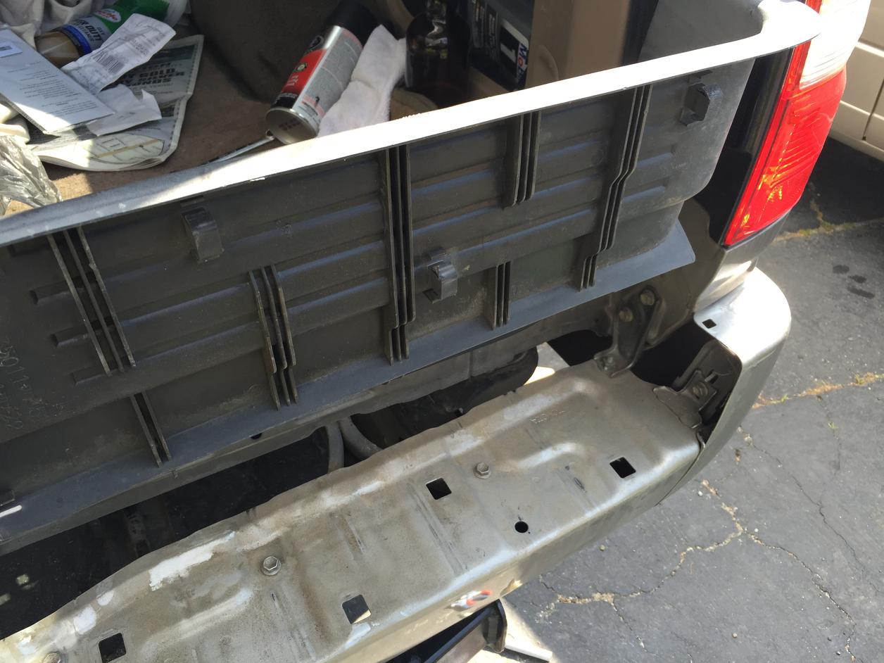

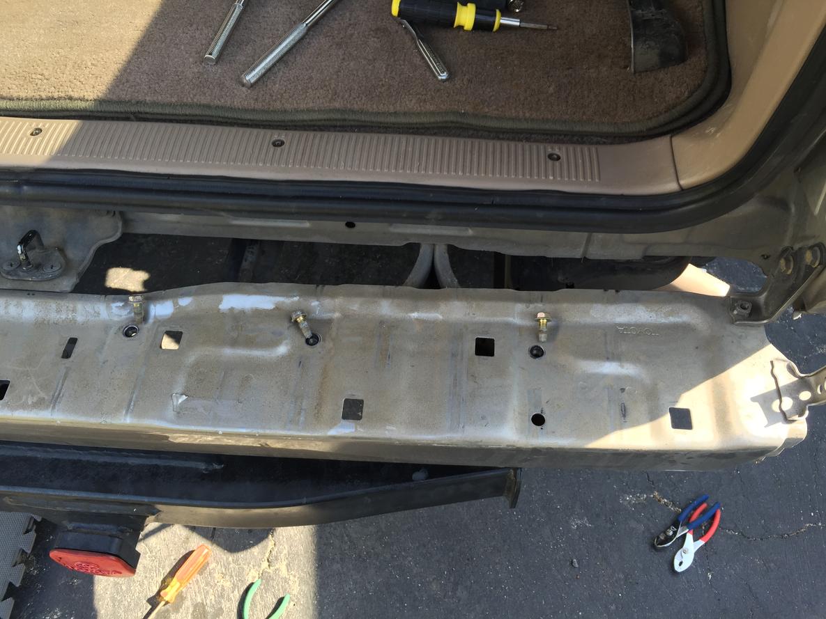

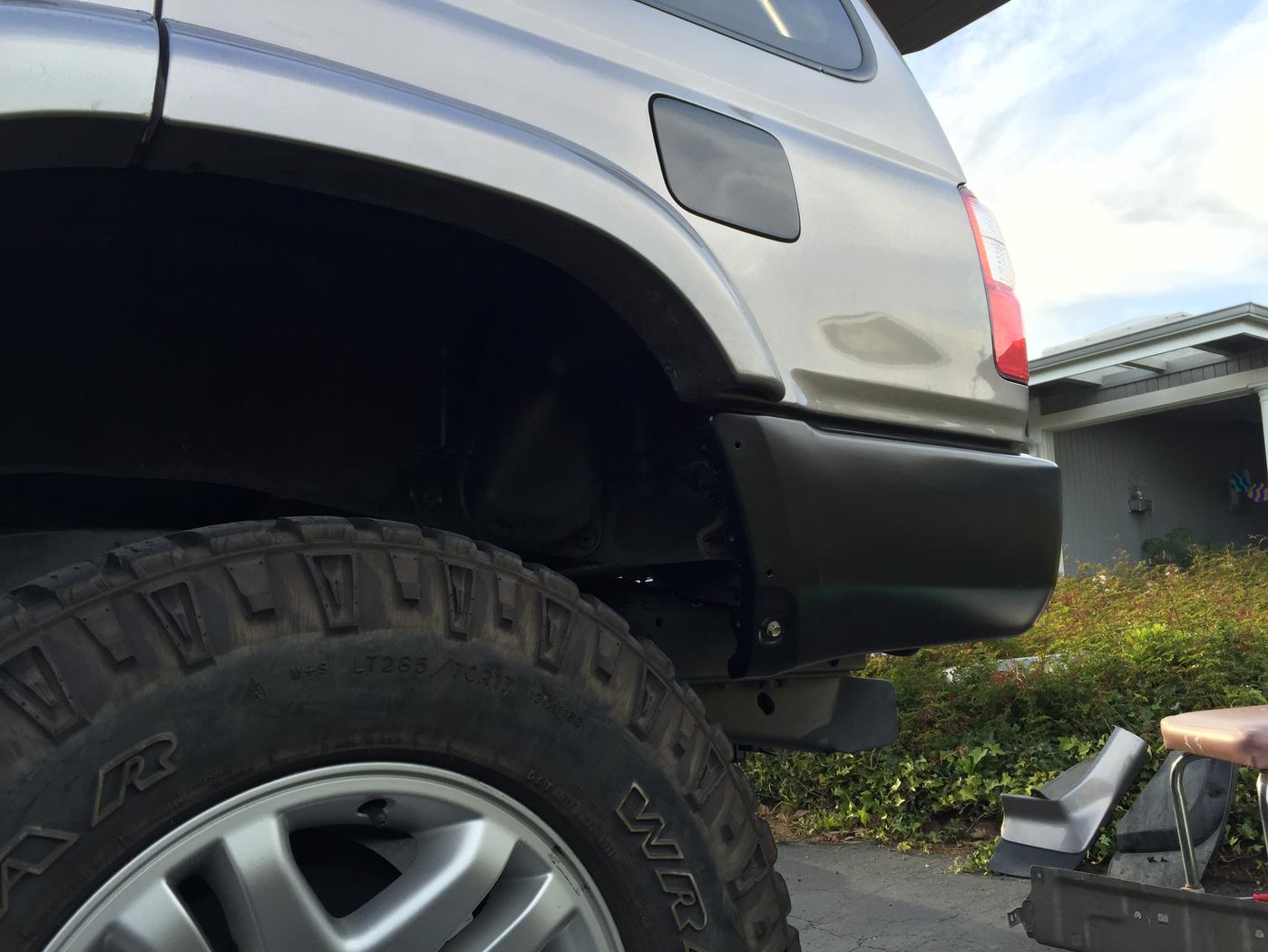

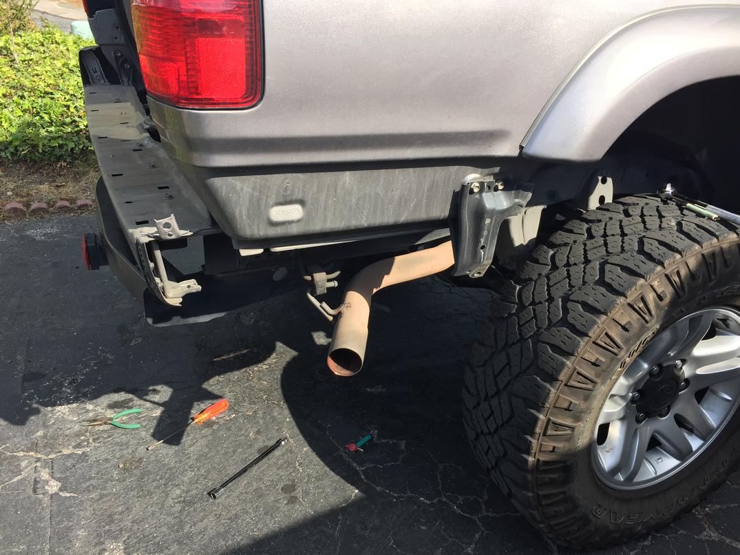

picture shown is only the top plastic piece of the bumper which technically doesn't require anything more than getting the clips through...
you absolutely DO have to remove the plastic bumper top valence part to reach 1 of the 4 bolts holding the sides on. (bumper is 3 parts)
but all the bolts showing are all 12mm
