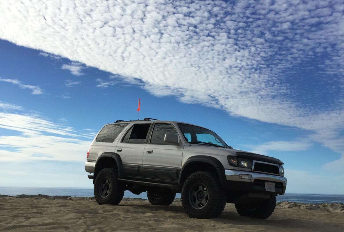

i converted my 99 faded, chipped, parts missing front into the dent free shiny chrome 96-98 version.

You should do what I did. Much less money, and I think it looks better th ank the fat lip.
Burtman Industries front lip for 96-98 4Runners

Would you care to write an overview of the parts and process to do this conversion? It looks really good and I wouldn't miss my fat lip probiscus at all!
Is that the 99 grill you have on there ???
Yep, and I can get you one if you need when you're ready. I get compliments all the time, usually from 99-02 owners at the gas station, asking me why my truck looks newer. It's that front lip.

I'm telling you. If I park mine next to a 99-02, you will like my front end much better. It's all in the lip :)
it's really easy.
Remove the 99-02 bumper
Remove the bumper reinforcing bar
buy 96-98 bumper w/ it's mounting bracket (99-02 bracket will not work)
buy turn signals (i used the old bulb and socket from the 99 and forced in the 96-98 light housing - it doesn't exactly fit)
everything else just bolts up.
One thing I realized after doing this conversion, is that since I have removed the reinforcing bar, the bumper provides no protection to the front end. So I want to invest in an armor.

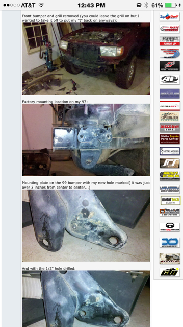

I saw a forum online somewhere, where the guy just had to drill a hole to mount the bumper to the original 98 mount... He didn't mention any new brackets or anything but if I buy a complete set they're both about the same price brand new so it won't matter what year I out on... The only difference would be getting the brackets on
There is a write up on, I think Yotatech. He OP stated that you only have to drill an additional 1/2" hole for the braces to convert the new bumper to a 96-98.
