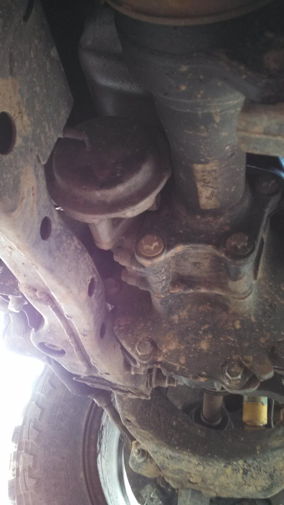

You are correct, this could be a real fiasco to troubleshoot. here's what I can tell you up front:
There is an actuator that engages your front differential when you press the 4WD button. It is in the upper left hand corner of the attached photo. It should have some vacuum hoses and an electrical plug going to it. Verify that all these look good. If the vacuum hose has come off I think it could cause you predicament. It may have come loose somewhere not immediately next to the actuator so get a nice flashlight and try to follow them.
the actuator and corresponding hosery can be seen here:
hope this helps.

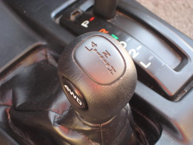

James - Thanks for your inquiry. We have an automatic. But I can't tell you if it's multimode or J-shift. BUT... I do have a picture for you of our shifters. It's the best I can do for now... and yes, I'm quite embarrassed that I don't know the difference! I have a feeling I'm going to learn a LOT about 4WD in the upcoming weeks. If this pic doesn't help you to figure out what I've got, tell me what info I can give you. Oh, and it's my first time trying to attach a picture - hope it works!!

Alright do you have the button on your dash next to your dimmer switch that looks like /-/
Anyways other then the multi mod having a short someplace I would look under the driver side at the transfer case there should be a blue plug with 2 wires going in and 2 going out, if there is corrosion on those connections I believe it will make the truck think the 4wd is engaged when it really isn't. You can unplug it first and see if it fixes any symptoms
Yes - I've got that button on my dash. So what does that mean... J or multi-mode?
Hubby will pull the truck in the garage tomorrow and start investigating. Thanks to you guys for your suggestions - it's a great starting point!!
Multi mod you have a awd function and it seems as though something might be shorting or sticking in the 4wd system. In awd it shouldn't be hard to turn but when the diff lock is engaged (button on dash) it will be in full 4wd and be a pain to steer on the street.

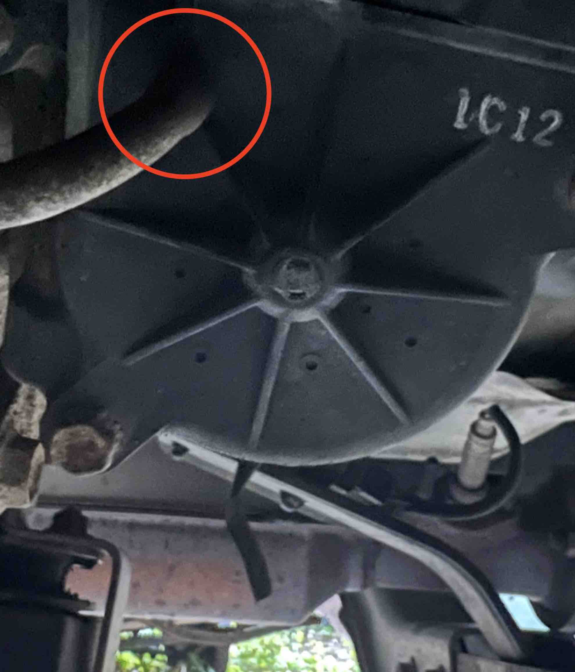

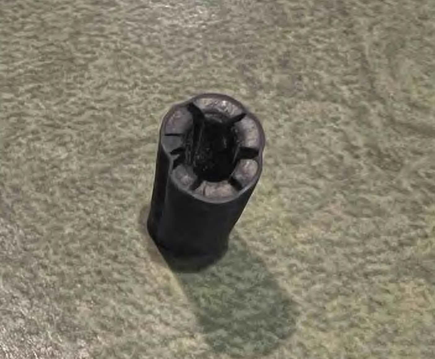

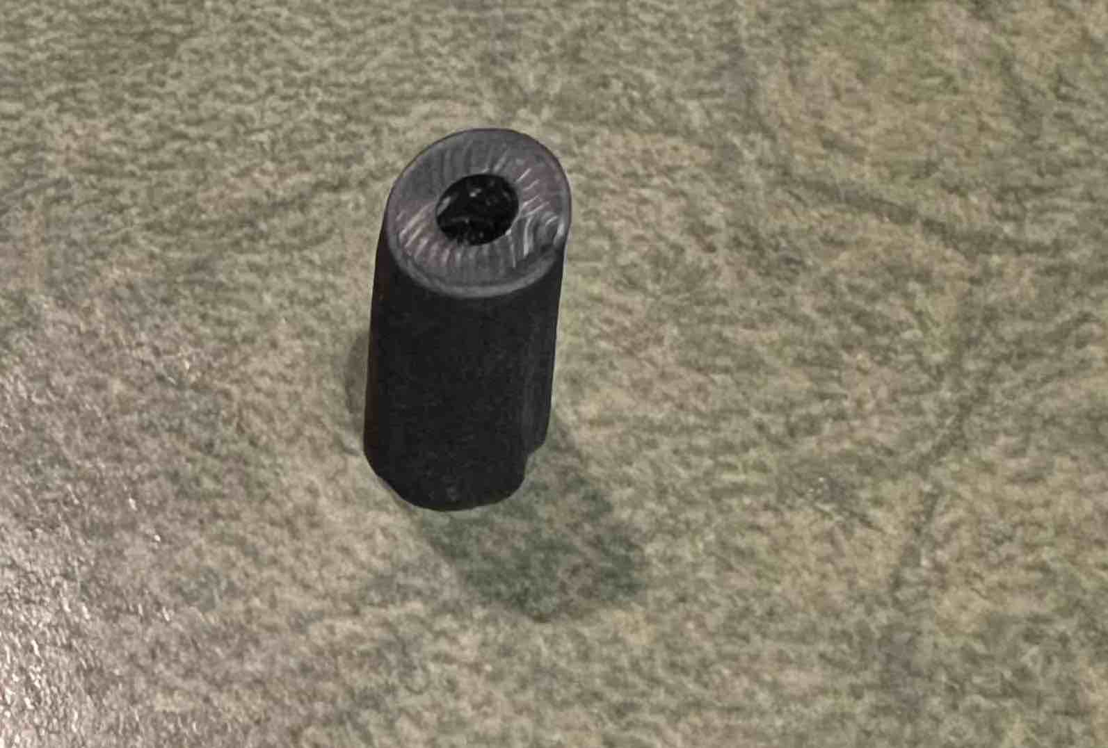

I recently encountered something similar with my 2001 so wanted to add my experience now that I've resolved it in case it helps anyone else.
My original issue was that pushing the 4wd button on the shifter resulted in the dash lights blinking (green wheels and center orange), but not stopping to show it was fully engaged (green wheels only). Like OP, I tried it a number of driving tricks, checked the fuse and disconnected the battery, but nothing worked. I removed the Transfer Case Switch (part #8422212010) to check for continuity as I've seen in other videos, and it seemed to be working fine. However, I sprayed it with a cleaner before reinstalling.
Despite folks saying there's no vacuum line on 2001-2002, there does appear to be one that goes to the Transfer Case Actuator though I didn't trace it back up to the engine bay. The end of this hose was cracking and barely attached to the Transfer Case Actuator. I cut the hose back about half an inch for a fresh end and it then fit tight to the TCA. Pictures attached of the hose running to the TCA and before/after of the hose end.
I took it for a test drive and had the same blinking problem I started with. While it was blinking, at low driving speed I pushed the dash switch and that lit up "VSC OFF" and the green wheels and orange center lights stayed on solid. When I pushed the dash switch again to turn VSC back on, it resumed with all green and orange lights blinking. With VSC on (no dash light reading "VSC OFF") and the lights blinking, I accelerated a bit more than moderately and as I slightly lifted my foot off the accelerator, the green wheel lights stayed solid and the orange center light disappeared. 4wd working once again!
I pressed the button the shifter to switch back into 2wd and repeated the process of pressing the shifter button, accelerating solidly, and as I lifted my foot it once again successfully made it into 4wd

That hose is a breather for the ADD actuator. It vents higher into the engine bay. Owners manual instructions state that if the 4wd system blinks that you should try accelerating/coasting, steering side to side, or try reverse to help the system engage/disengage.
EDIT: misread and assumed that you were at the front ADD, but regardless it’s a vent hose for the actuator.
He was talking about the transfer case actuator... but your comment is still true - it is just a breather line. On the transfer case, it runs up to the shifter area.
-Charlie
-Charlie
Good catch. I saw “vacuum hose” and assumed ADD actuator since 96-00 were vacuum operated. Thanks for the correction.
