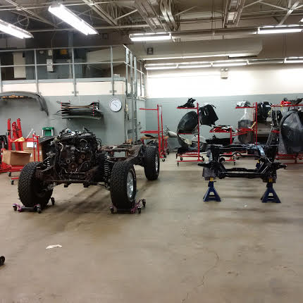

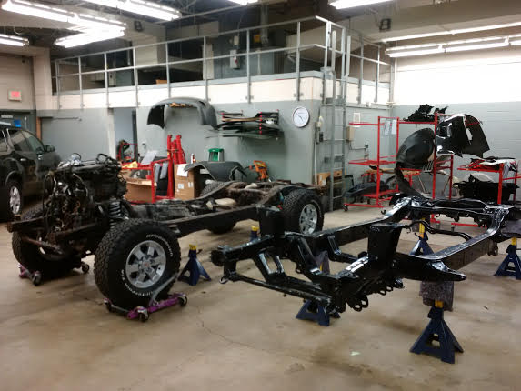

The time finally came to make the decision if I should put anymore money into my truck to keep her on the road. I have a 2003 4runner with 245,000 miles, I cant let it go, so I figured go big or go home.

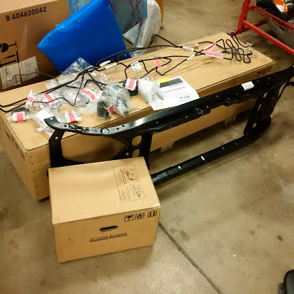

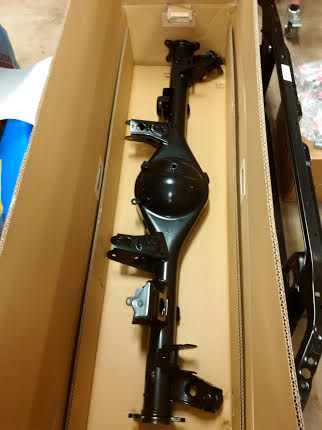

OEM Toyota 4runner frame
New Core support
OEM Rear end
OEM loaded diff
OEM front and rear stabilizer bar with links
OEM brake lines and gas lines
Gas tank straps
Body Mounts
RT, LT Bracket crossmember 4.0
RT,LT splash shields
Front, rear, LT,RT brake hose and brackets

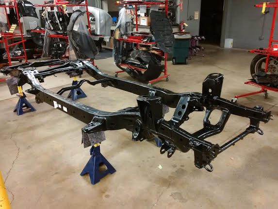

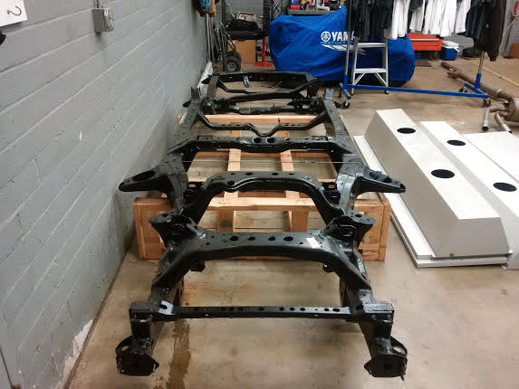

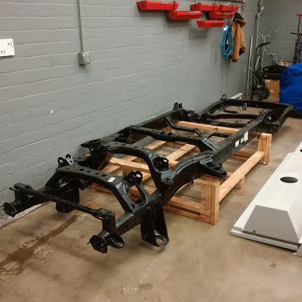

I found a used half of frame out of junk yard and the rear panhard bar and upper control arms where both intact and barelly rusty. I sanded them down and currently have 2 coats of por15 paint on them. They need couple more coats and they will be good as new. They are turning out awssome.
I went with the toytec ultimate 3 lift. I ordered them silver to match TRD FJ 16's
I put SPC front upper controls arms on and rear lower spc control arms.
I bought OEM lower control arms front the front and painted them silver in the paint both. hard to keep clean adn free of rock chips but they are holding up well.
Factory Skid plate

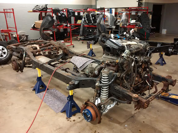

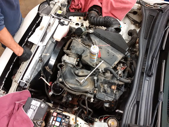

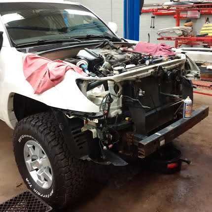

Disconnecting everything from the body
Started with the hood, then disconnecting all wires and lines from the engine block. it seemed that removing the front bumper would allow me more room and easier to get to small places
A lot of PB Blaster haha

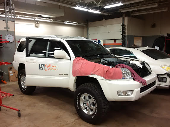

2003 Runner
Finished about a month ago, have been fine tuning still. runs beautifully
