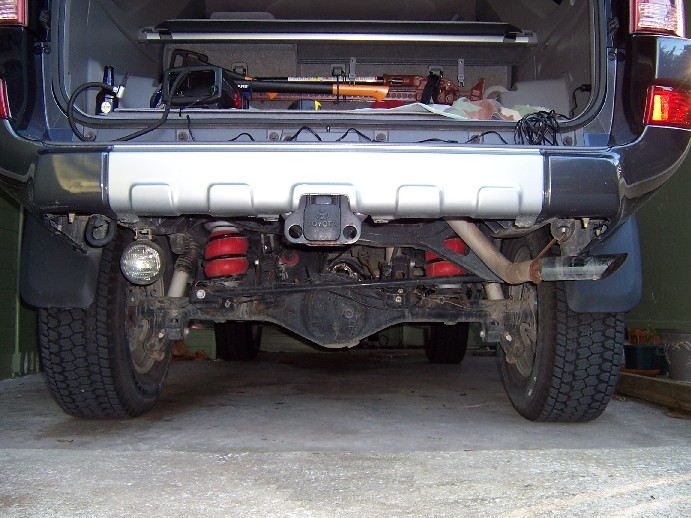

May want to add a set of the Airlift1000's.

Colemanfu - what does the airlift1000 do?
Think of it as the poor man's rear air suspension :D
Basically it gives the rear suspension more support & prevents the back from sagging when the rear of the truck is loaded down or you are towing something with a heavy tongue weight.
I think you can get a set of the airlift 1000s for around $85
LSU is spot on - an inexpensive way to stop the sag when fully loaded. The air bags fit in the coils and stiffen them up a bit. Kind of like a huge bump stop. They have air lines and you can adjust from 0psi to 20psi. I run mine unloaded at 0-5 and when hauling around 12-15. Makes for a stiff ride if pumped up and unloaded.
Colemanfu - nice looking rear end you got there :D. I have the Airlift1000 ($85.00) and Hidden Hitch ($162.00) ordered.
