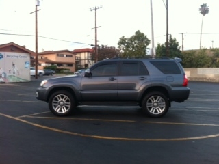

I joined the FJ site and posted WTB ads and got all 4 TRD shocks and coils from a 2011 FJ with a few hundred miles. I love the ride and stability of my Runner now. I didn't use any spacers and the front is approx 1" lower than the rear, which is fine for my needs. I've thought of leveling it with a small spacer but haven't yet.
This will likely be the cheapest route and best results for the $$$. I installed everything myself and it was really easy. Search FJ swap and you will get tons of info. My truck and many others are in this thread.
BTW The pic in my signature is before the lift. I'm attaching a pic of her now.

Looks good..did you need to drop differential? Like your 2010 wheels harsher ride A little?

The new limited wheels didn't make the ride harsh at all and I didn't need a diff drop. The truck brakes evenly and has very controlled braking now, compared to before. This is one of the best mods I've done to my truck.
It looks like it should and handles like it should with the FJ suspension.
