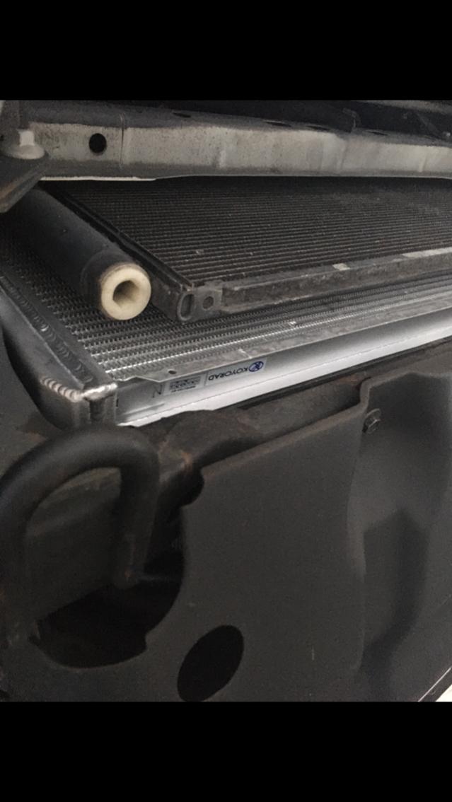

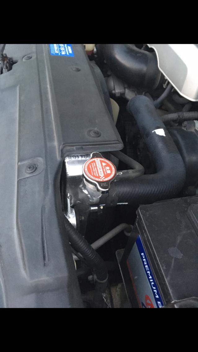

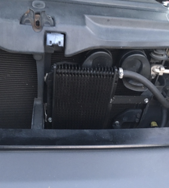

I'll take some later this week. It's very clean and built to last. I went with oem rubber hoses since this is a street car and silicone hoses require you to constantly add coolant since they are 15x more permeable than rubber. . The main reason why I got this radiator was the sheer durability. I want something that would last forever and never leak. My goal is to go 1 million miles. And if they ever do leak you can always fix it by welding the crack in the aluminum. So no need to ever replace it ever again. I also replaced the entire coolant system. So all new oem rubber hoses and new fan clutch. Keep in mind you need to get an aftermarket tranny cooler but don't get one too big unless you are doing heavy duty towing.
