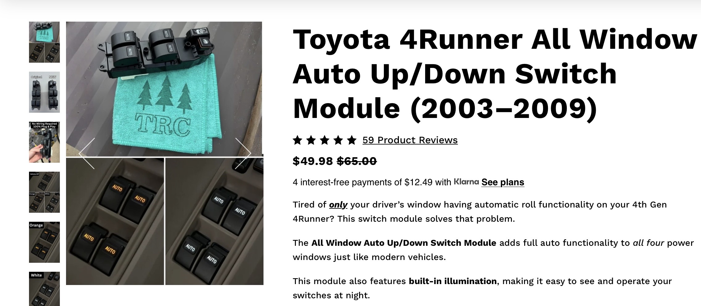

While surfing on youtube I came across this video for the drivers side control that has auto functions at all 4 windows. Bought one on ebay and installed it. Super easy and took me about 15 minutes start to finish. Seems to work well. I kept the factory unit just in case it craps out in time, but for now its great. Has anyone had any failures or problems with this on your truck?
Auto windows vid
I definitely like the auto up/down on the driver's window and wish it was on the passenger. I rarely lower the rear windows so I wouldn't need it there. But that's a great find. Be sure to follow up on this post if you have any issues.
Wow, very nice. I've lost count how many times i've said I could use this. Also, I thought I saw on amazon where you can get illuminated rear door window switches (unfortunately not Auto down/up)
i did the old school way, wired in 2 dei 530t, 1 module is for 2 windows, ran dual 14 gauge speaker wires directly to the motors, so all doors have full auto up and down, every switch has one touch, also wired to my security system, so it auto close when armed, also able to crack open and vent. heard these aftermarket switches don't have the auto jam protection.
