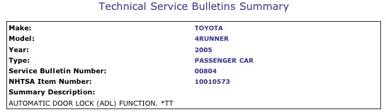

There is a Technical Service Bulletin about this for the 2005 model, but probably for other years as well.
