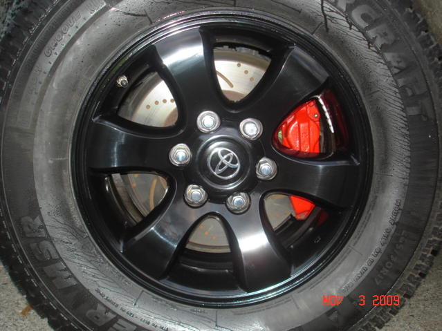

replaced my rotors and pads with EBC green stuff. all i can say is awsome stopping and NO squealing.
