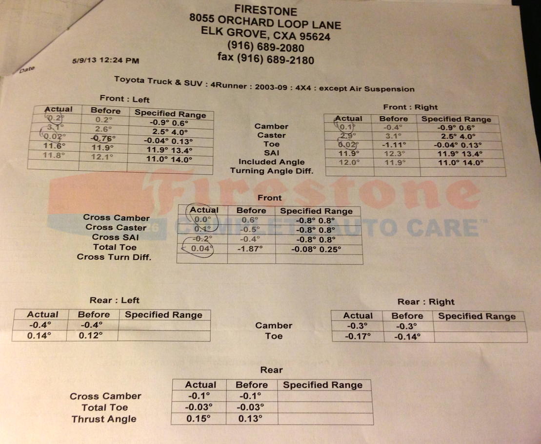

20130427_180244_zps76adfad6.jpg~original
let me know if its hard to read. This is from when i first got it done.
A tad hard to read. Off to drink some coffee & maybe then I'll compare them...LOL....For comparison, here's mine. Again, it's not bad, but just seems it can be better.
Caster : 3.7
Camber 0.3
Toe: 0.05
Seems like the caster might be a little high, but, I'm no professional.
Mine are more in the 2.6-2.9 range. The rest of the numbers on the both of you 2 looks close to where I'm at.

Hmm...pretty close. You have Light Racing UCA's, correct? I still think it's my Duratracs. Of course, it could also be driving the 4R back to back with the S4 that makes it seem so off...LOL...
Yessir, i have the LR UCAs and the caster setting was so the flat side is out. I believe that was +2.
My set up is close to yours LTDSC, except the stiffer rear. No issues like stated above.
The guys at Les Schwab on FLORIN & 99 did mine, and do all these modded/lifted 4x4's all the time.
