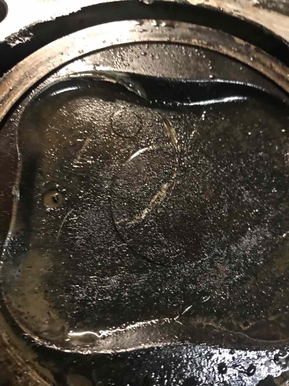

It was a blown head gasket. Plus it looks like the valve hit the piston. We really just need to get the 4Runner to sell. Don’t want to sink to much money in it rebuilding the engine.

If a valve hit the piston you have other issues then just a head gasket.
