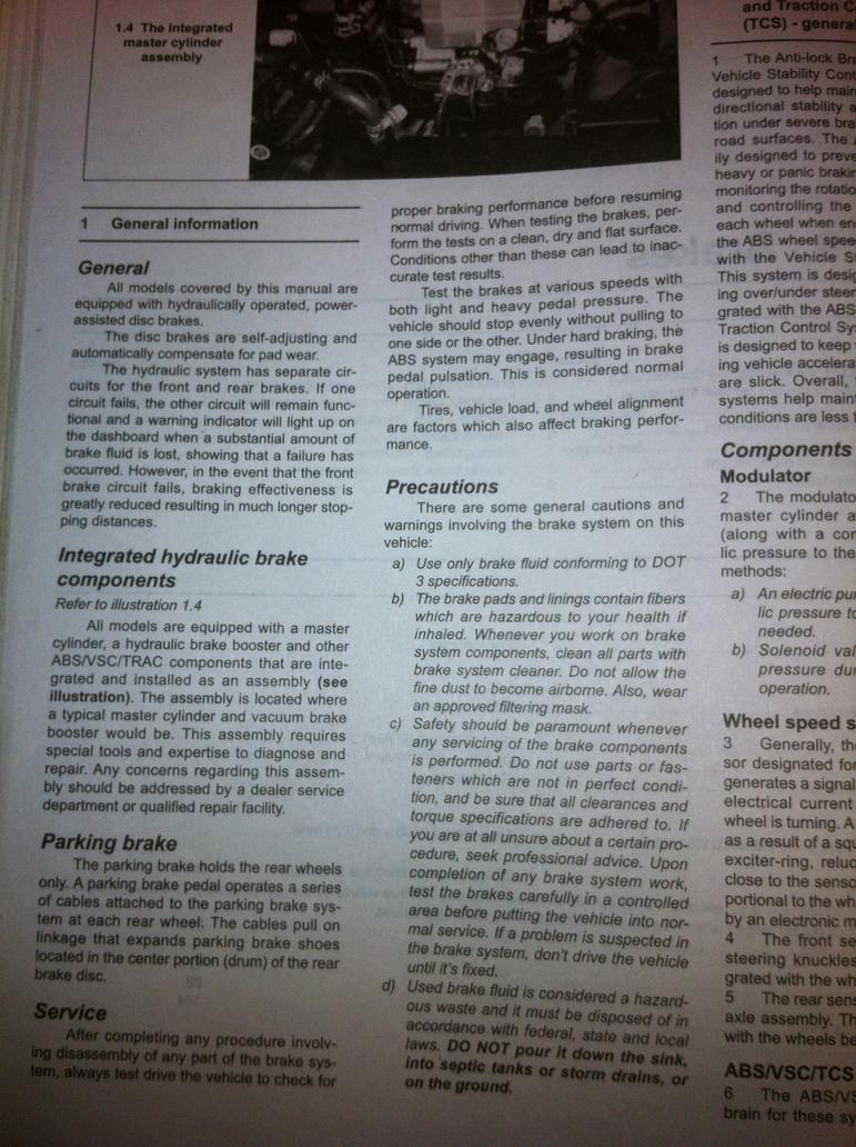

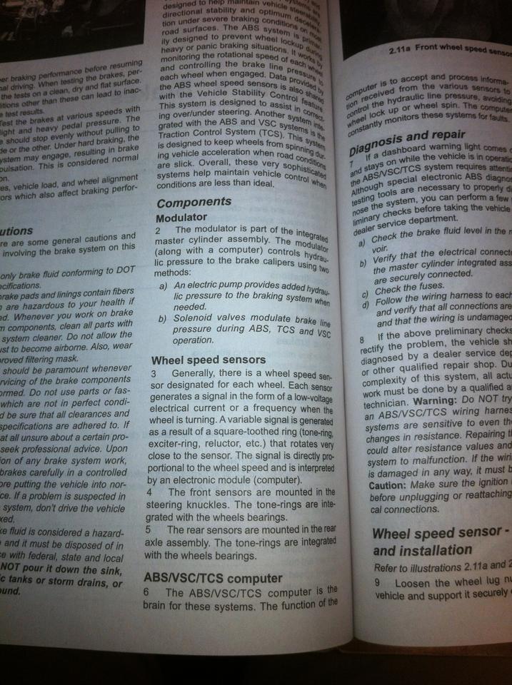

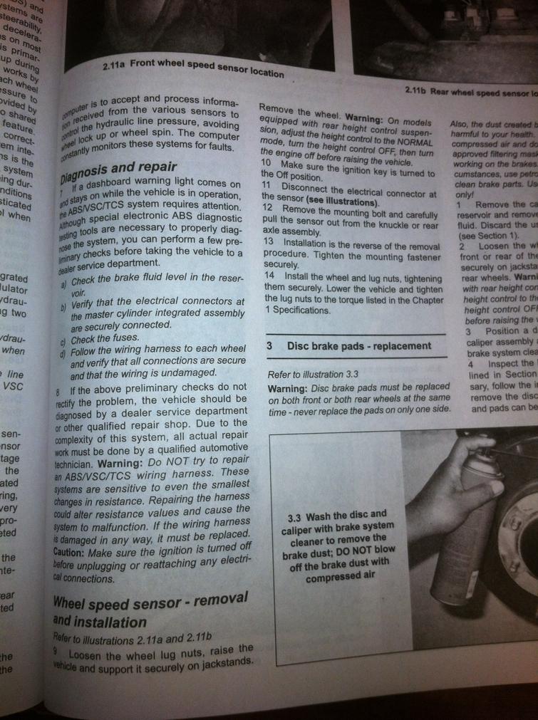

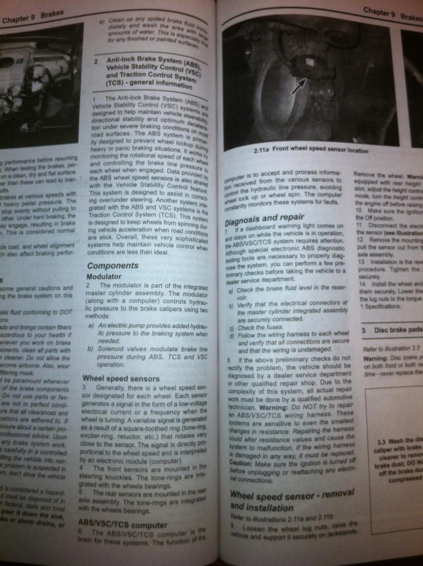

I looked in the few manuals i have and they all say check connectors, fluid level, wiring harness's, and if none of those validate the problem to take it to a "qaulified tech" lol no offense just ironic because your proceedure is to just replace the whole thing. but it looks like you can buy a few of the componants pretty cheap the pump and the hydraulic control unit are the big kickers
