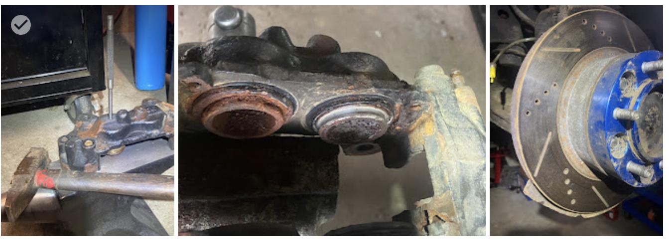

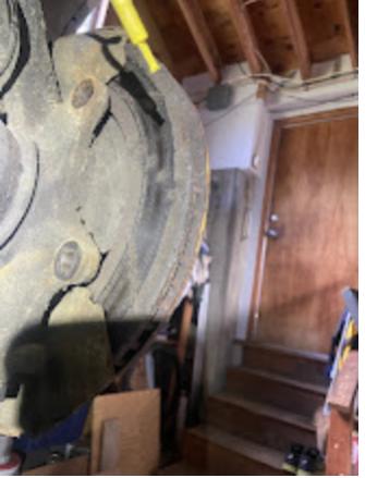

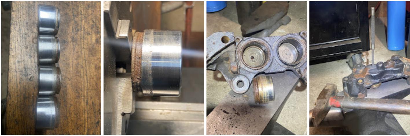

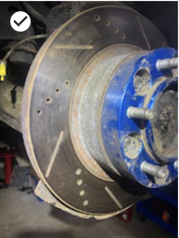

Update after removal of Right Front caliper.
During removal I already saw the mess on the backside of the disk.
It turned out that one inner side piston was entorely stuck which forced the second piston to compensate.... but this is a mess as we know. One piston did not move any more and the second tries to do the job but of course it has only 1/2 the force of the okay outer side. It is entirely asymmetric to a point when the steel disk is bending in theory... I guess there could be a bigger 'Spring effect' until the brake really bites.... This does the following
A) reduces braking force
B) I might lead to a much bigger fluyid volume to pump until the brake does anything
C) The large amount of fluid moved means that the accumulator is emptied much faster than it should.
I am simply trying to understand my symptoms better...why they occur (remember brake motor running every second time and bad brake performance).
I was guessing this might be my problem for a long time but did not follow up until now.
The stuck piston: I drilled a hole into the housing opposite of the stuck piston and hammered it out with a punch.
You also see that the outer edge of 3 out of 4 pistons has corrosion.
How could that be as this is a rebuilt calipe I bought from Napa 3 years ago, maybe 3.5 years?
The paint or powder of the caliper is entirly failing... My guess is that the flaking off powder at the seals let water and moisture inside and thus the pistons were starting to corrode.
It would be so much better if they did a proper paint job, or imply do nothing.
In the last 2 pictures you see the outside of the disk (looking good) and the last picture is the poor inside of the disk (looking bad). I'll probably not change the disk.
What am I doing now?
I think I will buy a set of rebuilt calipers to get some traction... buy time and then I could rebuild the old calipers over winter.
Best, Martin
