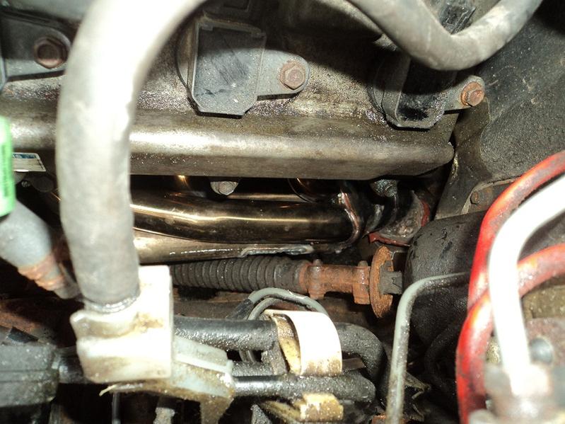

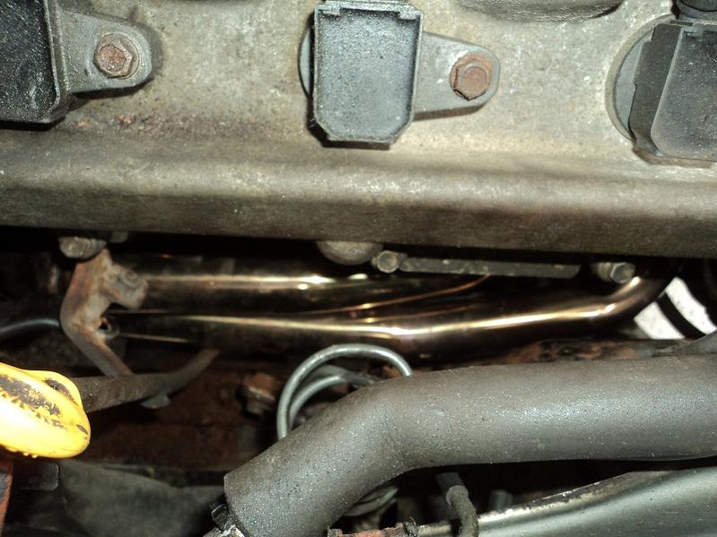

Well its been 11 months in the making but they're finally done and I couldn't be happier! They sound and look great and best of all...NO MORE TICK! Plus the whole system from the engine to the tail pipe cost what I was going to have to pay for just Toyota manifolds not installed
The original design had to be modified abit to clear the steering shaft and the Oil and Tranny dipsticks had to be moved slightly but other than that they fix like a glove. I had him reuse my stock cats to keep costs down.
As expected it through two codes, P0037/P0057 Heater Control Circuit Low (Bank 1, Sensor 2/Bank 2 Sensor 2). Not the code I expected to get from moving the cats so I'm going to look into it abit but most likely just get a couple URD O2 sims.
EDIT: Haven't gotten a chance to get a updated 0-60 time yet since its be raining but I will post the results when I do.

Little update on that situation...I crawled under my truck to meter the sensors and found that both rear sensors had been left unplugged. So I plugged them back in and am interested to what happens. It will get rid of the current codes but I could see it throwing a P0420 code now that it'll get feedback from the sensor. I should know it a couple days.
Since my truck is in my shop now in pieces! The TICK came back when under load so I took the headers off and looks like they reused the old beaten up gaskets so I'm going to replace with new. If you want something done right, you got to do it yourself!
The shop makes a great product, but the installation/customer service is below par. It's a shame because now I'll never go back, fool me once shame on you, fool me twice shame on me.

Yah the quality of the headers is top notch, couldn't be happier there. The flange is like 3/8" thick stainless, she'll long outlast my 4runner.
As far as the ticking issue, they say they did use new gaskets so I guess the only possibility is that the header loosened off and the escaping exhaust damaged it. Oh well, I going to put new gaskets and see.
I bet you'll just have to re-tighten them...I had the same issue with mine...I'm not sure why it happened, but after it was re-tightened, the ticking subsided. Good luck and look forward to hearing a sound clip when done!
Yah I got the new gaskets installed today and it sounds great. No ticking, I'll re-torque the bolts after a driving abit. Not sure my digital camera will record the sound good but I'll give it a shot.
