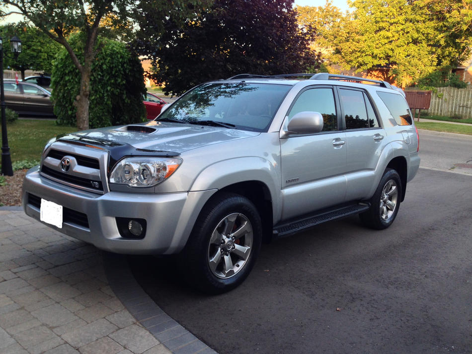

I recently bought an '06 Limited with 172,000 km. It still had the original Cross Terrains on it. First thing I did was replace the tires.
Here it is while still wearing the Cross Terrains. The Cross Terrains were so badly worn that just putting the new tires on gave me a 1" lift.
172,000 Km is amazing for a set of tires. I know Michelins usually wear well, but that is remarkable.
