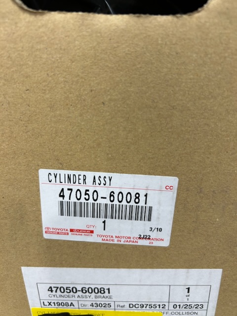

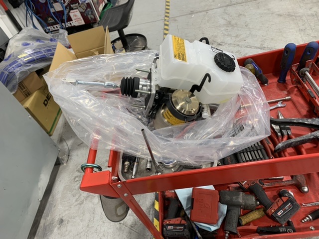

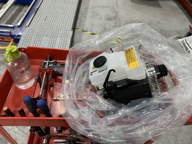

It’s definitely not a $3000 part but it is pricey for sure. I just picked up that unit for $1300 from my local Toyota dealer. I think your cost on it runs roughly $1700. Used is an option but you could run into the exact same noise on a used one. I’ve also read people having them rebuilt but I’m not finding the answers I like to hear and read about for me to take a chance on a rebuilt unit. So I went new and am going to install and bleed it myself. Almost everyone with a 4th gen has to have this discussion with themselves and their runners! You definitely have options you just need to make a decision.
Thanks for sharing, this one seems to be complete ABS Unit. Can you please share the dealer name/location? Also, what is the part number in this case for complete unit?

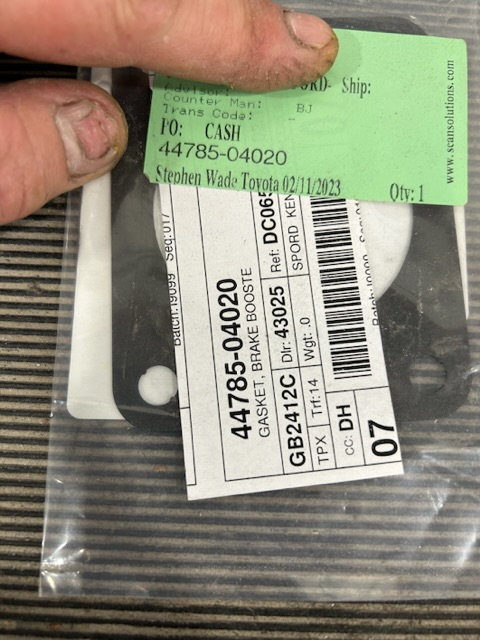

Same part number as mentioned above. Don’t forget to order your gasket when you order the booster it is a non reusable paper gasket.
