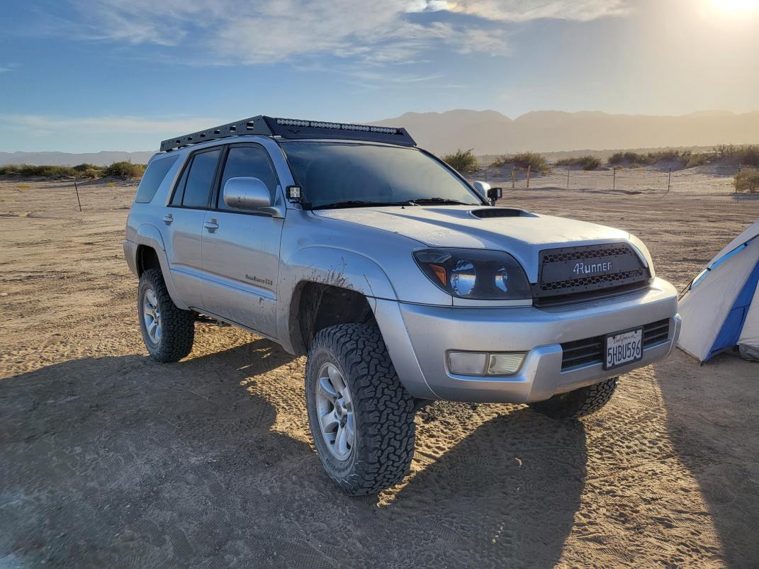

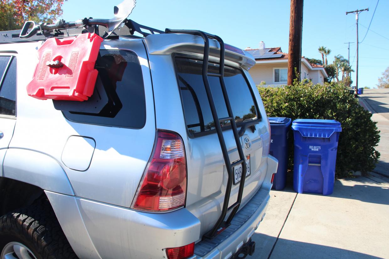

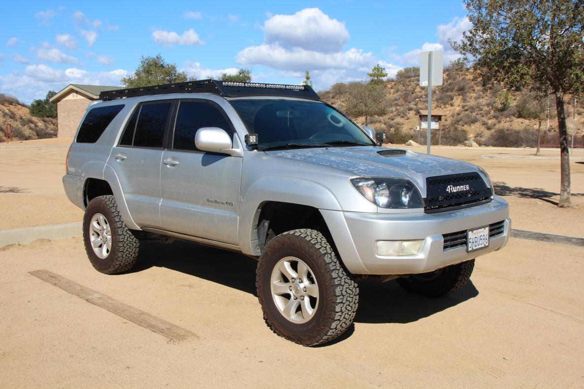

Hello,
For those who want this post in video form here is a video I made private for this post:
4th Gen 4runner build 2004 v8 sport - YouTube
Here is the list of stuff and where I got them:
Parts:

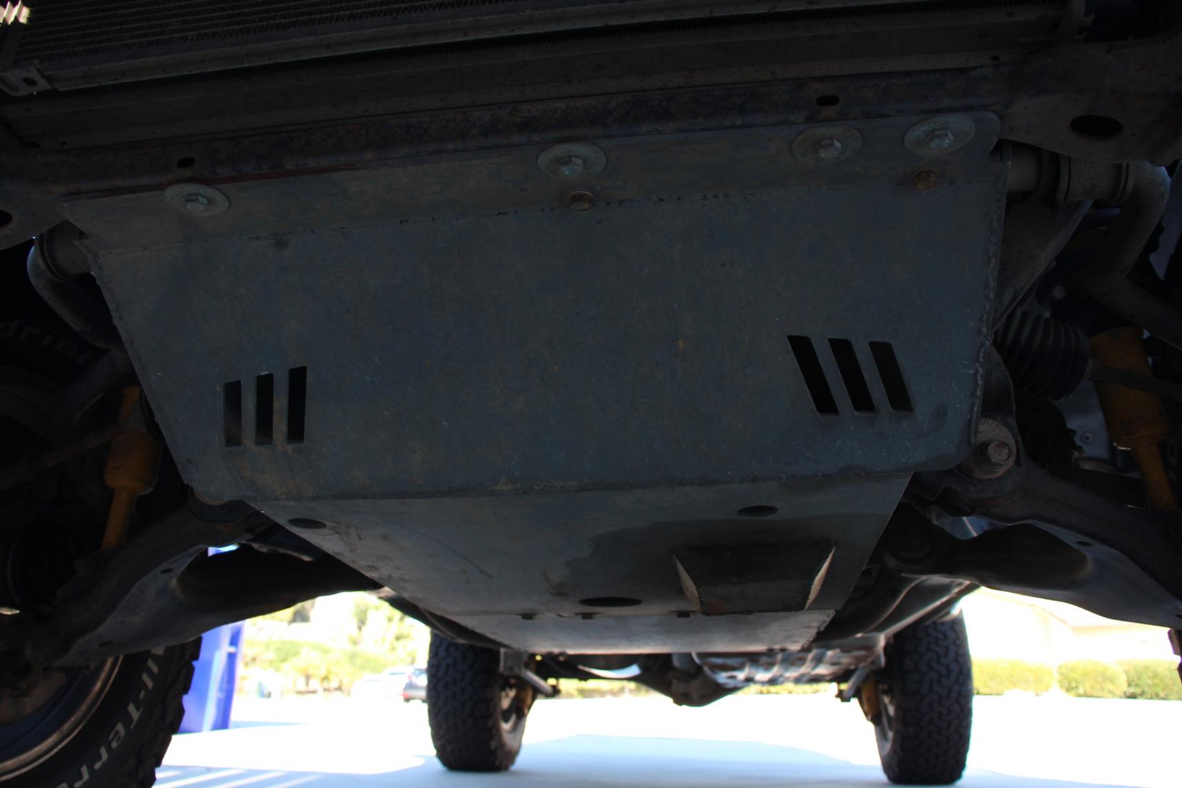

Skid Plate (weld together Kit) Coastal Offroad- Good slim clearance
4th Gen 4Runner/ FJ Cruiser/ Lexus GX470 Skid Plate Kit | Coastal Offroad

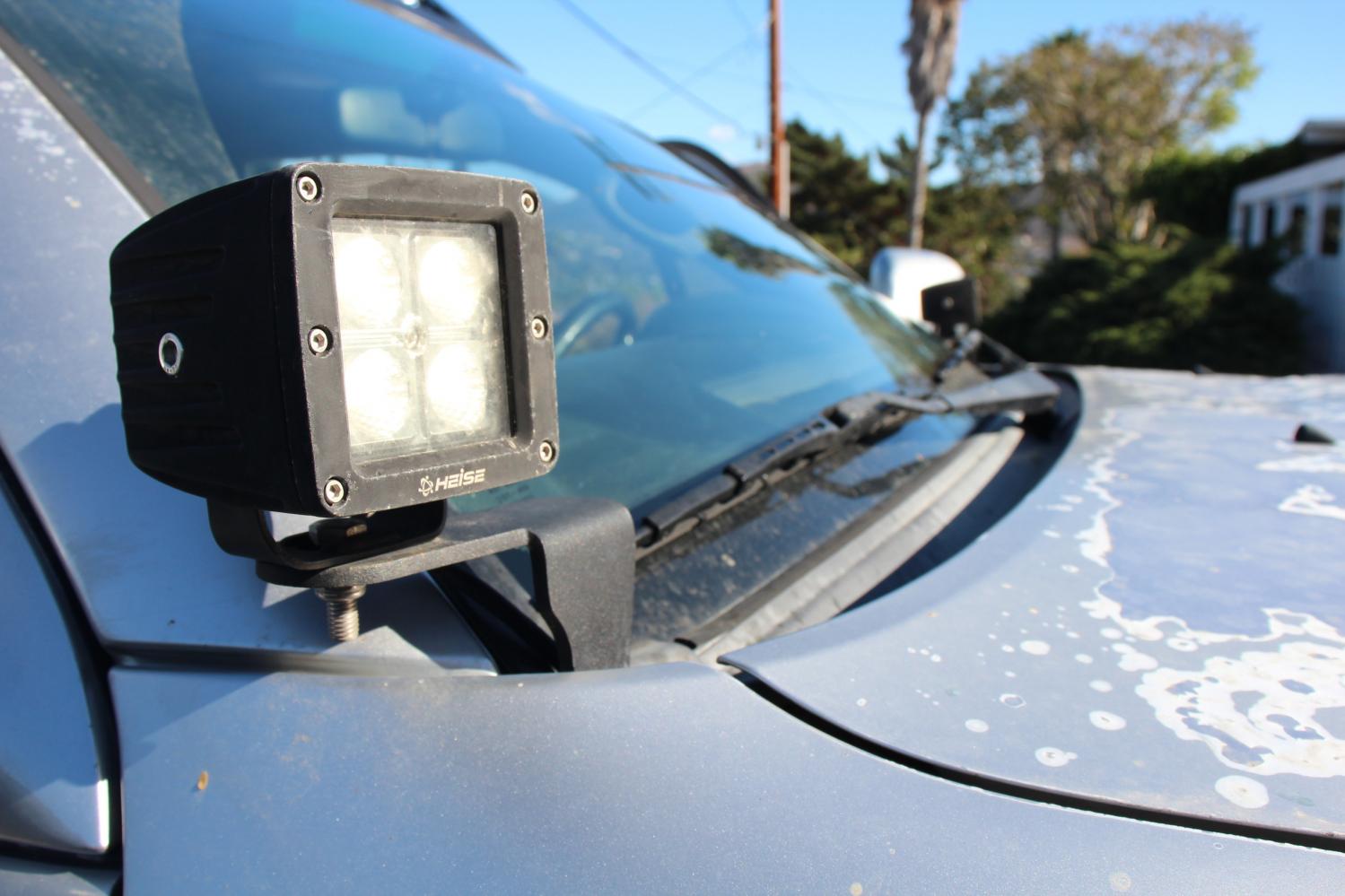

Ditch Lights: Heise Heise LED Lighting Systems | Torture Tested Lightbars and More |
Brackets for ditch lights made by Cbi
CBI Offroad Fab - 4th Gen Toyota 4Runner Ditch Light Brackets -

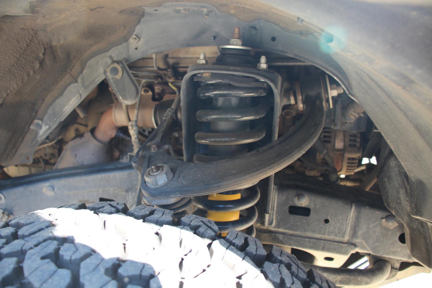

Lift OME Old Man Emu 2-3" Lift Kit (4th Gen 4Runner)
OME Old Man Emu 2-3" Lift Kit (4th Gen 4Runner), OME-4R0309 Lift Kit
Front Coil Configuration:
886
Select Front Shock Configuration:
OME-90021 : softer valving
Select Rear Coil Configuration:
895
Note: You will need to remove the xreas system completely which is super easy just literally pull everything off.
½ in spacer above the coilover https://a.co/d/bjFpjO7
1.25in wheel spacer https://customwheelaccessories.com/
Spc Upper control arms:
https://yotamafia.com/product/spc-a...s-2003-2009-toyota-4runner-fj-cruiser-tacoma/
Tire Size: 275/70R-17 BFGOODRICH KO2 E https://www.tirerack.com/tires/tire...KO2RWLV2&vehicleSearch=false&fromCompare1=yes
Note: if you lift your 04 without wheel spacers on stock wheels you will rub the upper control arm, you will need spacers.
Only thing I needed to cut was the plastic wheel liner and I also removed the mud flaps
4runner Grill: https://yotamafia.com/product/2003-2005-4runner-grille-insert/
Exhaust: Toyota 4Runner BOLD x REMARK Cat-back Exhaust System
https://bold-performance.com/collections/toyota/products/toyota-4runner-10-19-catback-exhaust-system

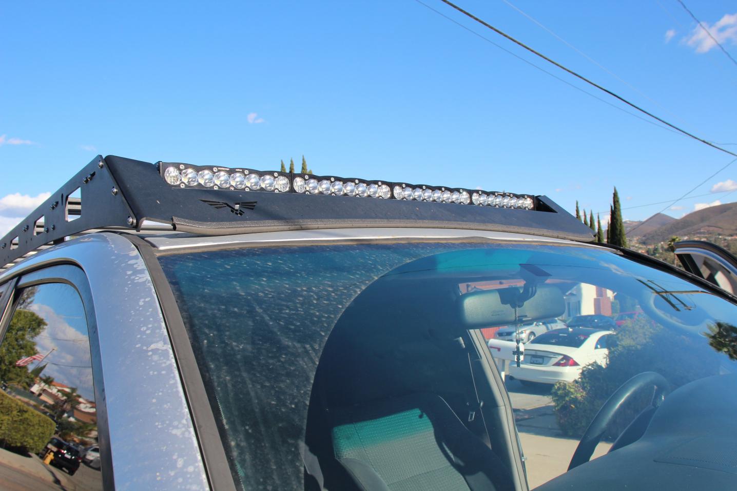

Victory 4x4 roof rack With Light bar mount: https://www.victory4x4.com/product/V4RRK.html
light Bar: Baja Designs S8 40" LED Light Bar Sold by victory 4x4
Roof Rack Side panel https://www.victory4x4.com/product/VRK-SAP.html
Gas Tank: Rotopax 2 gallon: https://rotopax.com/2-gallon-gasoline.html
Shovel: https://krazybeavertools.com/ Krazy beaver shovel
Rear Ladder: Gobi Ladder https://www.gobiracks.com/product/g...ear-ladder-with-spoiler-no-riser-driver-side/
Note: the ladder does slightly touch the victory 4x4 roof rack when the rear hatch is fully open
Headlights from yota mafia: https://yotamafia.com/product/2003-2005-4runner-headlights/
Weather tech front seats and back
Mods:

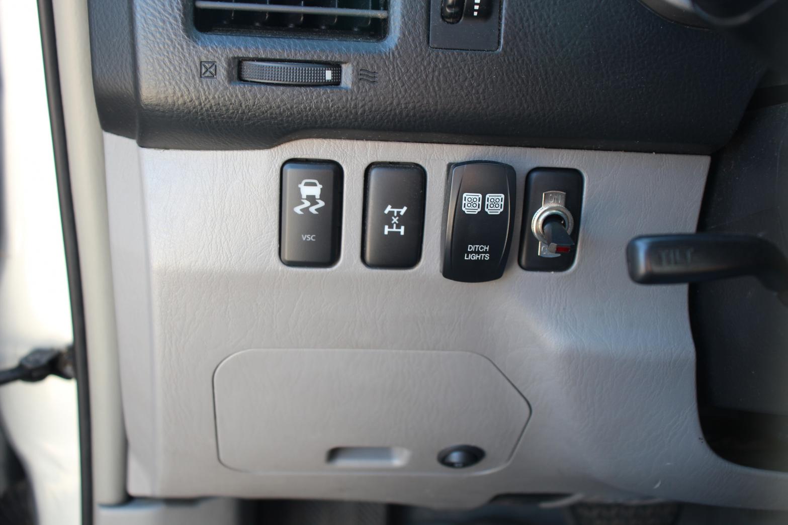

Traction Control Mod: speaker wire to interrupt the pressure sensor.
Hydrocarbon filter removal
Usb Charging port, tapped into Cig Lighter.
Trailer brake module

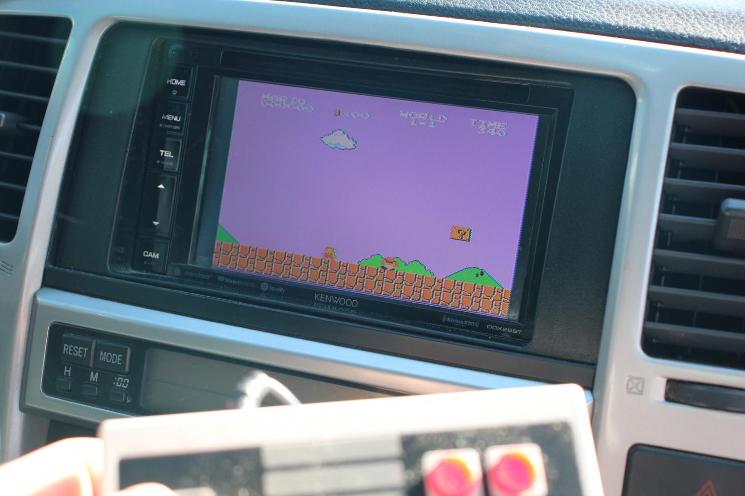

Kenwood head unit
JBL 12in sub
Full Tint
Recovery gear:
1in 30ft Kinetic rope
½ in x 22in Soft shackles
Cigarette lighter air compressor
Considering paint: But I like being able to drive literally through bushes and branches
Considering adding the Pedal commander for better throttle body response and eco mode.
Underbody glow: lol Maybe after I did paint so it looks cool on the street
Issues:
Removed xreas system due to system leaking
Xfer case seeping gear oil
Solution was a couple oz of blue devil stop leak.
