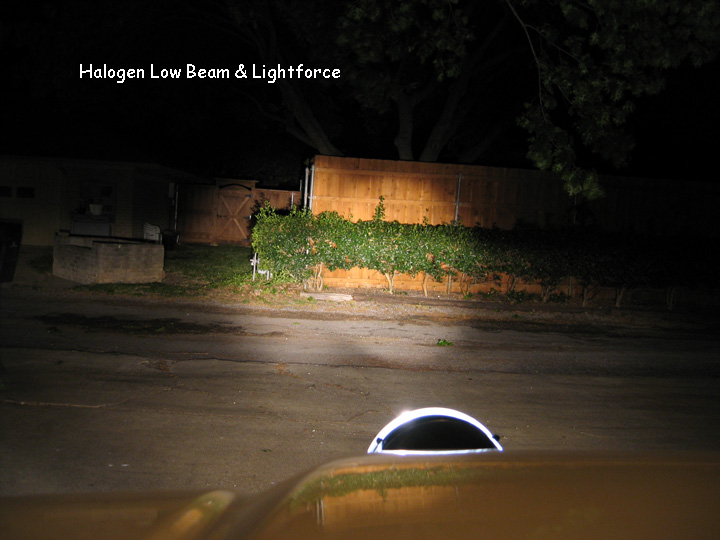

Low beam with my Lightforce. 100w bulb in each Lightforce, with the beam on a wide wash setting and the clear lens.

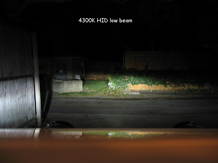

The 4Runner had to be moved over in the garage to make room for my motorcycle, so the view is over about 8 feet. But you can still get the idea of how the new HIDs work.

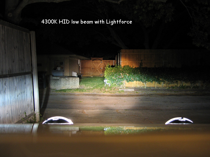

Here is the HID and Lightforce. As you can figure, the Lightforce can never be used in traffic. I use them to push cars out of the fast lane in the day, and for off-roading.

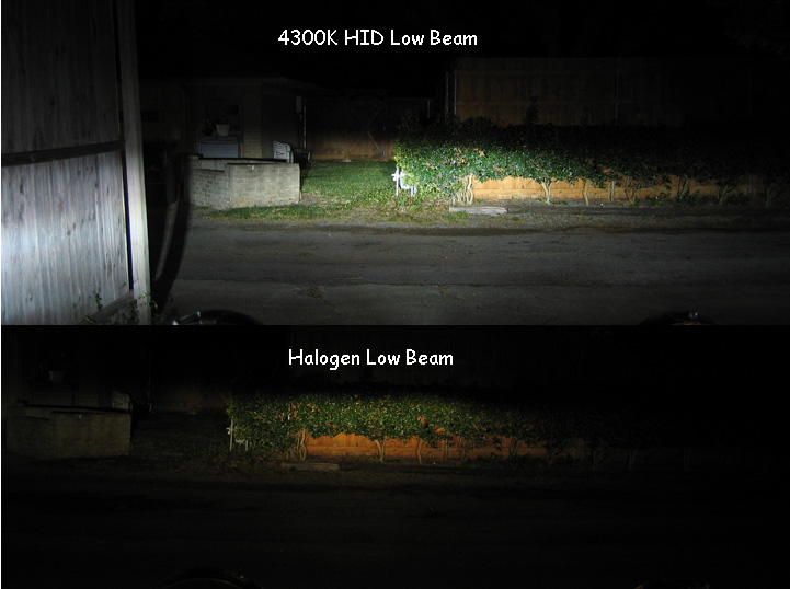

Here is a combo photo so it is easier to see the difference.
Yup, looks like the same output I got with the same kit. What issues did you have? What did you have to modify to work with the 4Runner? My kit was plug in play? The ground and power went on the battery terminals without modification...
