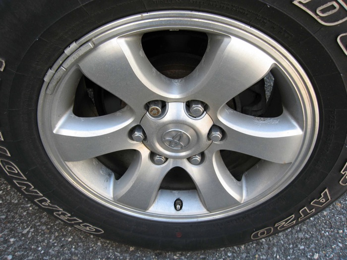

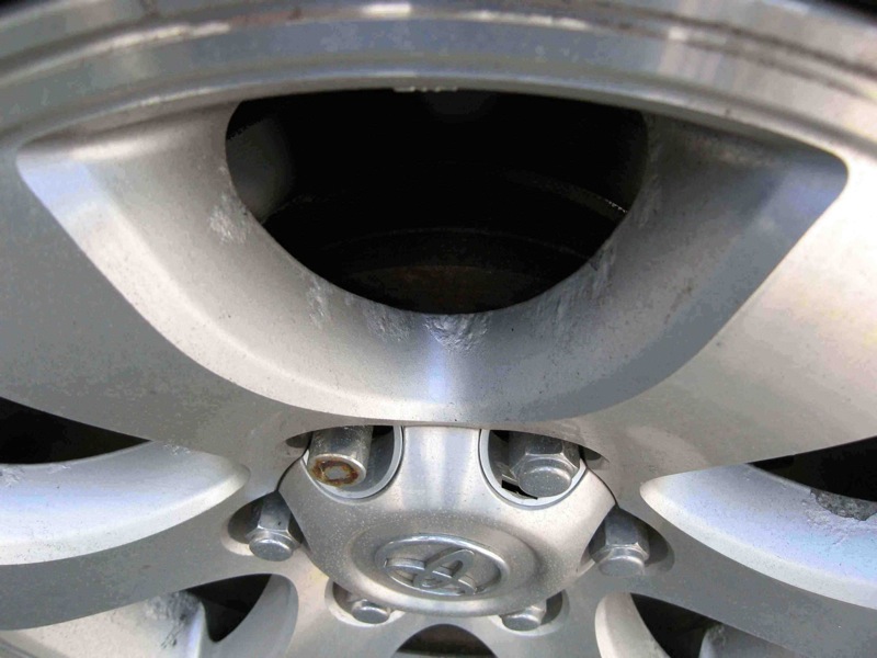

Do they look similar to this?
P8240012.jpg~original
P8240011.jpg~original
P8240009.jpg~original
Those are my Taco wheels. I took it to the dealer and their service director looked at it and said my Taco parked outside where the salt content and fog in the air are too much. So much for a vehicle built to last. (I seriously wonder how well it'll hold up off road, TuRD Off-Road package.) They also said, they never seen so much rust on the under carriage. In short, there's nothing they can do about it. (To their credit, they did replace the rear bumper about three months after I got it because the rear bumper was rusting near the license plate--water puddles.) I hate to bearer of bad news, but you're out of warranty, if you're thinking about the rust and body warranty, that's only applicable for perforation on the sheet metal. In other words, the metal has to completely rust through, bumpers (like the chrome one on my Taco) are not covered by that, only through the 3yr/36k warranty.

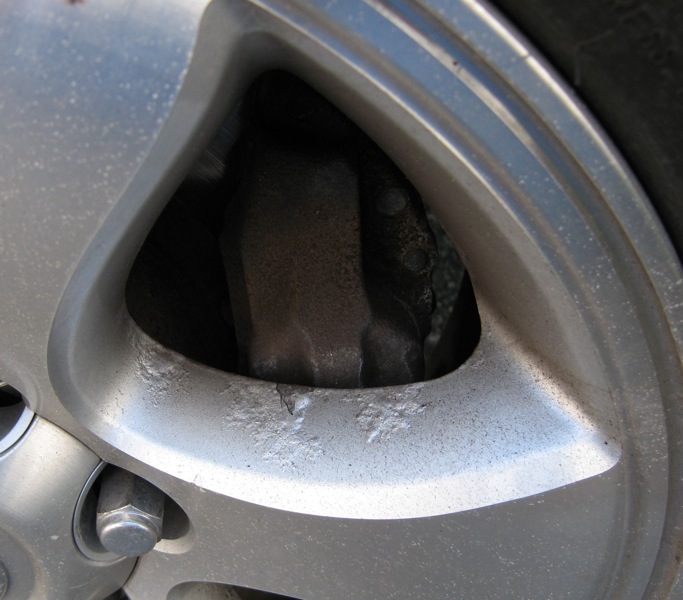

Thanks for the replies and advise so far. I had a feeling I was out of warranty but I'm still going to try to complain to the dealership. I did first notice the problem around 20,000 miles and notified the dealer during my oil change and tire rotation and they said let's "keep an eye on it to see if the problem gets worse. I have attached a few pics of the corrosion and it looks even worse in the picture. I'm due for tires and I just can't see installing brand new tires on crappy rims. And I agree 100% the Dunlops SUCK! I'm leaning towards the Bridgestone A/T Revos.
You can see in the far right of the image the paint is actually missing

If you have documentation of this, you should be able to get Toyota to cover wheel replacement, sine the truck was in warranty when you complained about the issue. If the service manager at that dealer won't help, go to another dealer that might. Or like I said, complain to Toyota. Tell them you are embarrassed to have a 35K SUV with pealing paint off the wheels are 20K miles.
