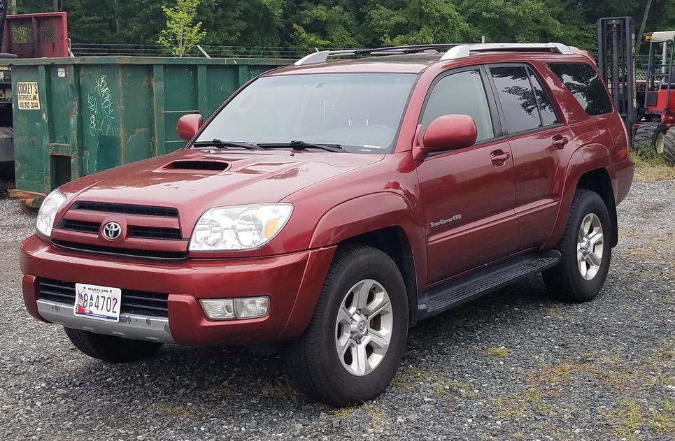

Friend of mine has a 2005 Sport that wouldn't start out of the blue. He took it to a shop and was told the timing chain jumped. $2000 a best but likely needs an engine. Truck has roughly 250K miles on it and ran fine up until this point. I find it hard to believe this happened after being parked and wouldn't start the next day. Anyone have any ideas? If this is a timing chain issue, is this an interference engine?
