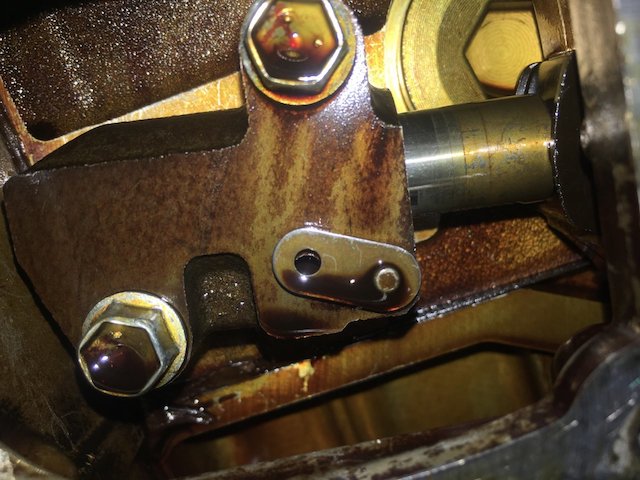

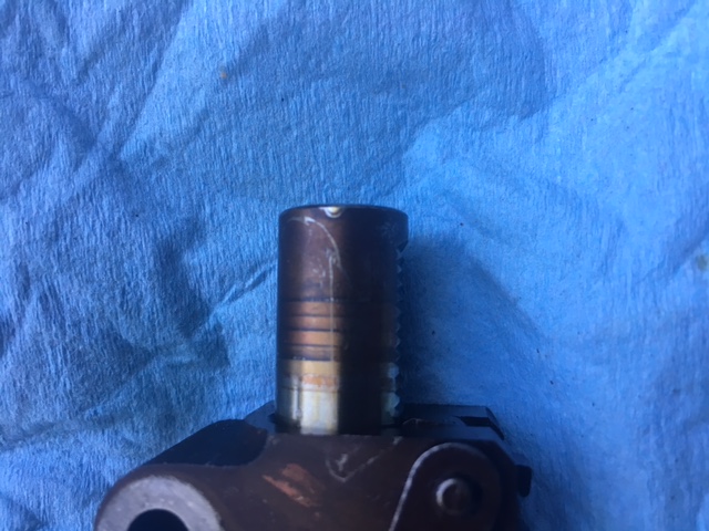

You can gauge chain length by the extended length of the tensioner plunger after removing the 4-bolt cover.
Factory new chain has the plunger at approx 1/4". Mine was stretched nearly a full link, and looked like this.

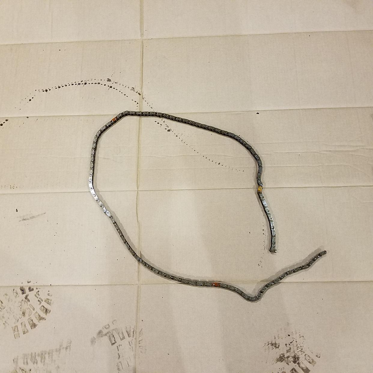

Well scratch that, coworker backed out due to money issues or more likely his wife not wanting another project lol. I did however confirm today that the chain is broken, not just skipped a tooth. Looking down the oil fill I can see the chain and it does not move while cranking the engine. Wish I realized I could see the chain sooner, would have saved a bunch of digging around. I'll likely order a chain kit and gasket set and tackle it myself over the next couple months. I have very little time to work on this stuff so may be a while until it's done.
That's a rare failure. I researched timing chain failures in the 1GR-FE engine extensively after I bought my 4Runner project last year, and did not find a single breakage. Plenty of elongation due to wear, especially in the '07 manufacture year.

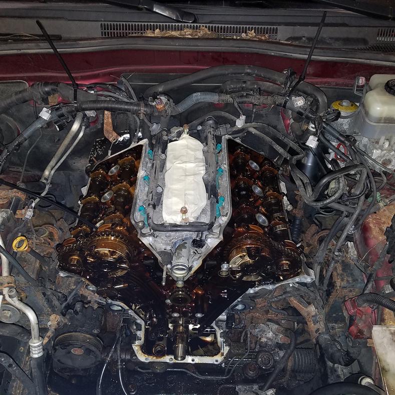

Started disassembly tonight. Not to bad for about 3.5 hours of work and my first time digging into one of these engines. Heads are coming off tomorrow. Not sure if there is any valve damage, engines are said to be non interference but I have no way to know and I really don't want to pull all this apart again. Never hurts rebuild heads with 250K miles on them anyway.
