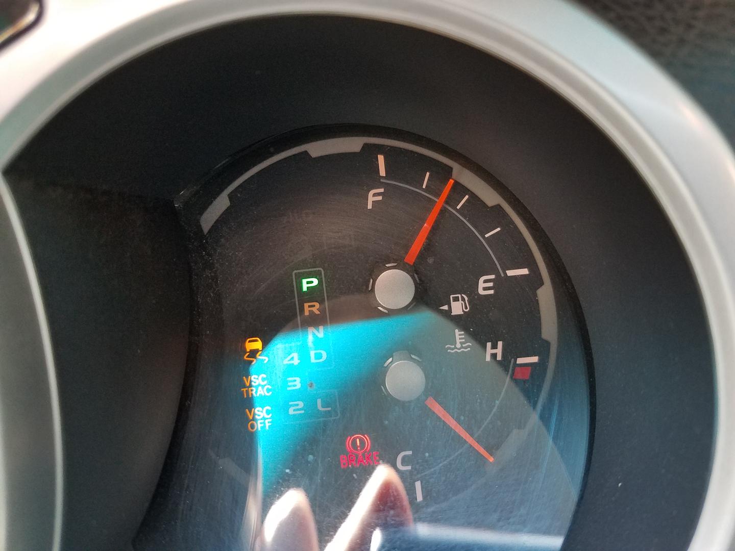

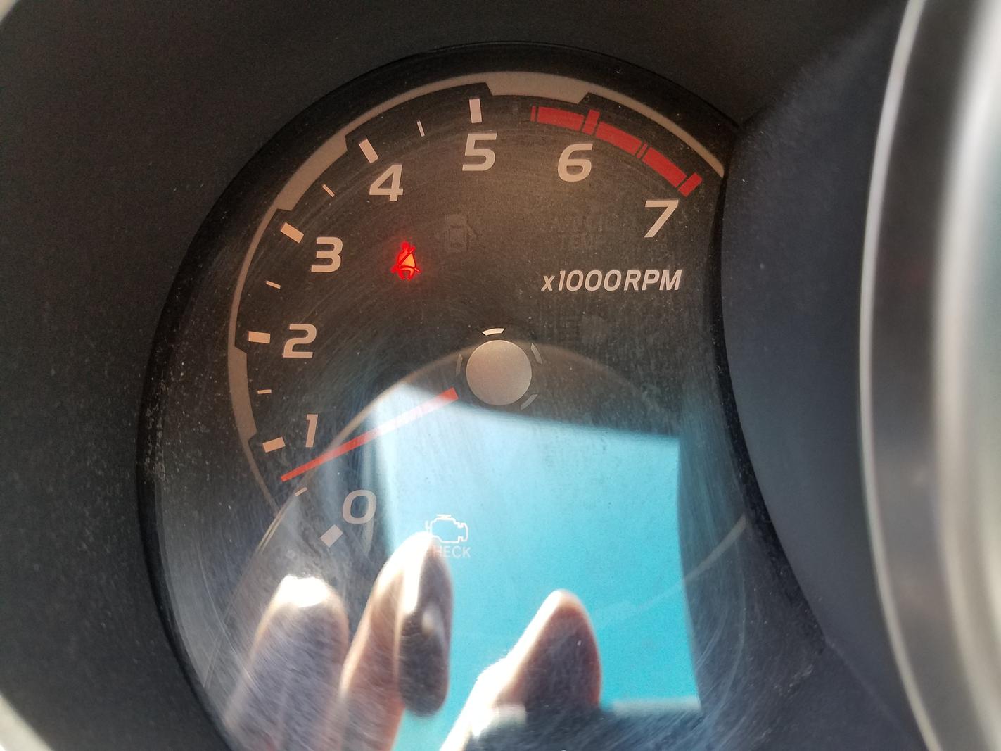

Hey everyone,
I have a 2005 SR5 that developed a recent problem. My engine, VSC, and Traction control lights are coming on and staying on. I tightened the gas cap but that didn't do anything. I then unhooked the battery and it cleared the lights for a couple of weeks but then their back!
Only thing recently is that I got 4 new tires (same size) and an alignment. Mechanic said timing valve cover is leaking oil (is there a tsb for this?) and to keep an eye on it.
Any ideas why these lights keep coming back on?

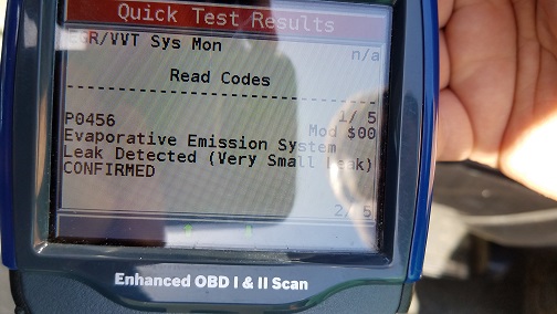

Alright y'all. I'm posting a pic of the OBD II code read out (P0456). It's a small evaporative system leak. I bought an aftermarket gas cap as mine was loose and figured this may be a solution. I've driven approximately 5 miles and the lights are still on.
Any ideas? Should I drive longer, get a OEM gas cap, or could be be something else? Thanks!

I've replaced with OEM. Also took a bit of driving for it to turn off.

As mentioned by [MENTION=88858]madeinhb[/MENTION] drive it some more, a few days IMHO, that system has to sit at least overnight to evaluate the system, the system test works overnight or several hours after shutting down to determine if the system has a leak or slow leak.
Just an update. It's been over a week and I've put 75 miles on the truck without the lights clearing. I'm going to buy an OEM gas cap and see if that fixes the problem. Other than that, I'll have to see if other measures are warranted.
I'll keep you guys posted.
So after a week and a half and 100 miles the lights finally turned off! I recently filled my tank again and ensured I tightened the cap 5 clicks this time. Apparently that did the trick! Will post if I have any other trouble but the aftermarket gas cap works for now.
