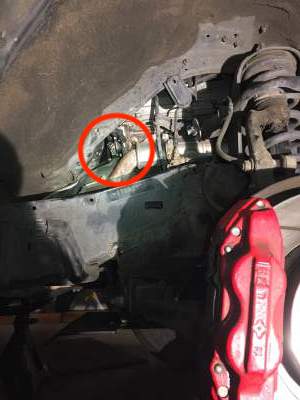

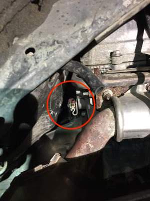

A/F Ratio Bank 2 (Upstream O2Sensor) Location
I know this is an old thread but I came across it when looking for this information so adding pictures in case someone else comes across this looking for A/F Ratio Sensor (Upstream O2 sensor) location. This is the bank 2 sensor (passenger side) for the 2UZ-FE V8 motor. Bank 1 sensor is in basically same location on the drivers side. I spent way too much time trying to remove the B2S1 sensor without taking off the wheel, just way to far up in there between the motor and firewall to reach it, after removing the wheel wasn't too difficult. Pics are taken from passenger side front wheel well, I had already removed the sensor but you can see the harness side connector which is clipped onto a mount at the back of the motor.
