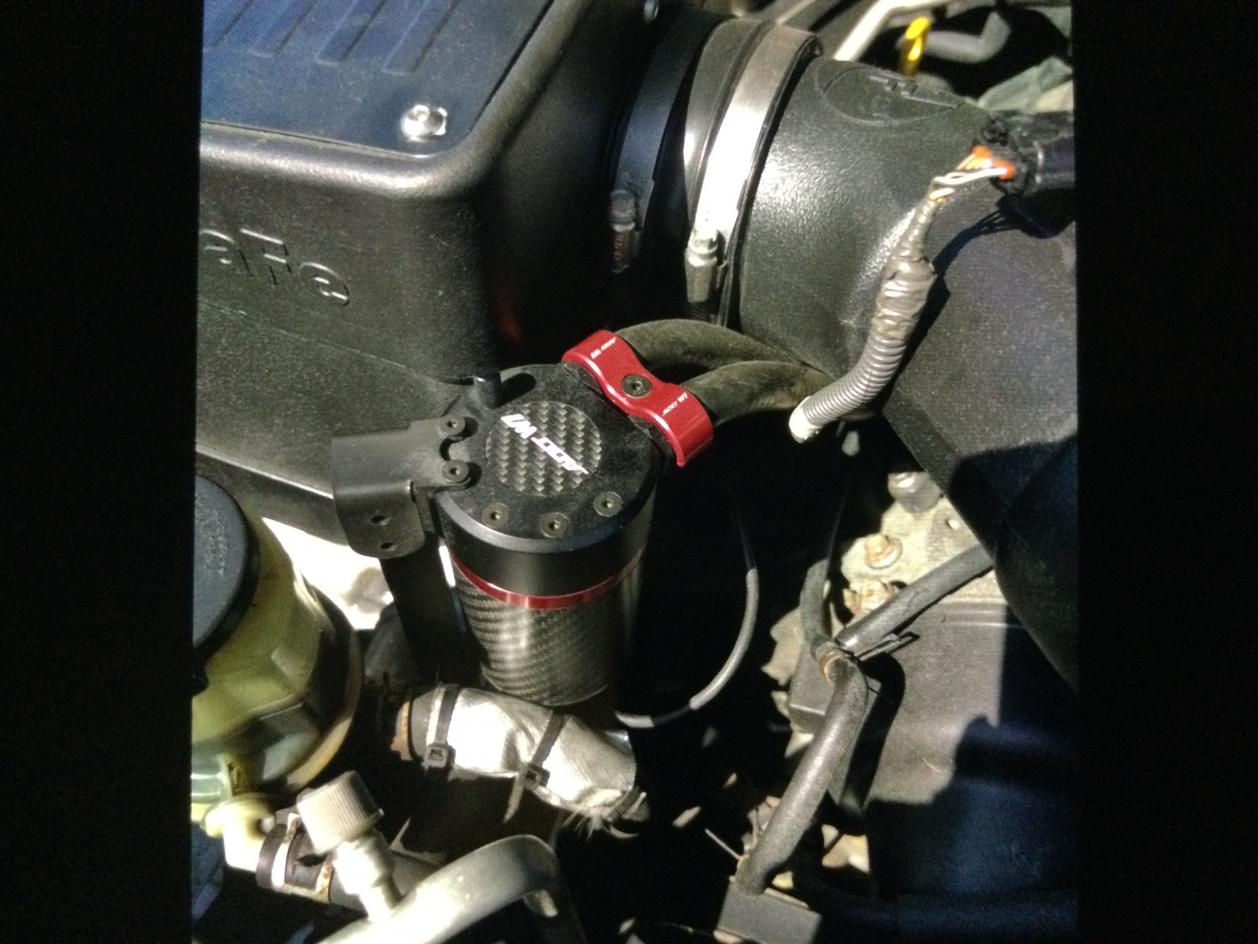

Just purchased a 2005 limited V8 4x4. Noticed it had an oil catch can attached. Upon further investigation. Looks brand new not one drop of condensation or oil in it. Since I am new to 4 runners looking for help on whether or not to keep it. Have not found anything here on a catch can on a V8. Any help would be appreciated.

Okay after further reseach I have found that it was installed in between the CAI intake to a pcv valve intake on the passenger side of the engine. From what I have found on the internet and other instructional videos. It’s the wrong place to install. I will be removing and reconnecting the hoses properly. Just an fyi if anybody else is looking for answers. Will update with results when done.

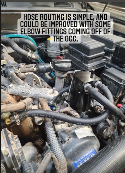

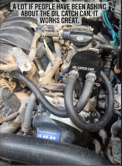

I was about to say, that catch can was on the wrong side of the engine. Got some pics here for reference
