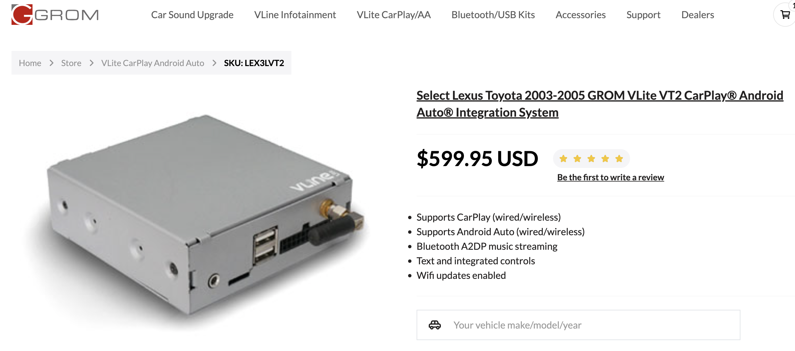

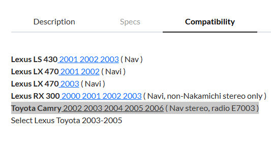

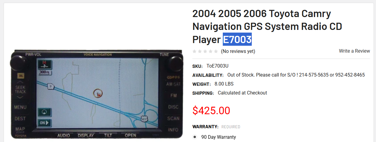

Grom makes a carplay interface for for "select Lexus Toyota 2003-2005" with specifically Toyota Camry e7003 in the compatibility specs, along with couple Lexus vehicles all from 2001-2006. Problem is I haven’t found anything online anywhere about having this system in e70xx nav units, only the lexus models which has a separate display cable and different plugs to the e7003 or e7008 and I do not want to drop 600 dollars on a interface that I don’t know will work in my car.

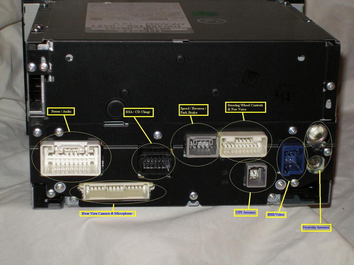

To my knowledge there is no way to get video input in the e7008 except the R27 plug for the RSE DVD player (which im still unsure if i can get my own video source through the R27 besides the DVD player as well as what video format it excepts.) I have found a universal carplay interface box that you install yourself but I need a way to get video and audio into the HU. There is also the problem of if the RSE DVD input locks out screen when you start driving so you are not distracted by any dvd while driving. I currently have no speed sensor or Ebrake signal attached to the HU but I do have a GPS antenna attached which locks out the NAVI controls while driving
This i also why I am wondering if the Grom unit works with the similar Camry E7003, how does that get it to display onto the headunit with no issues.

I've been skeptical of the GROM kits actually being compatible but they sell so many that I wouldn't think they would list E7003, 17001, and 17007 from 2002-2006 Camrys, which are pretty similar to the e7008, as compatible with the VT2 and VL2 carplay kit by accident for so long.

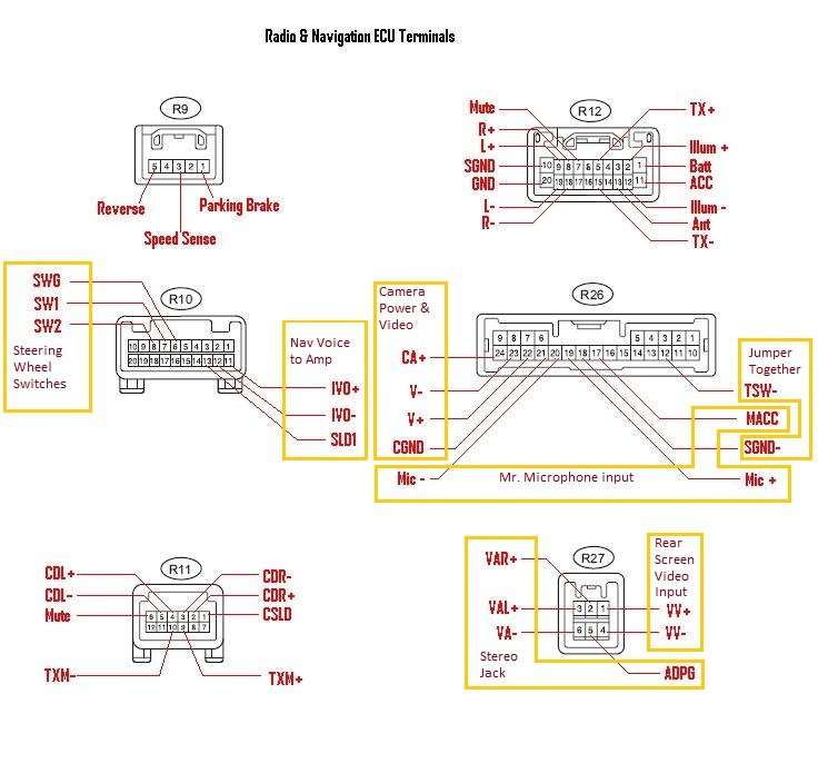

Update:
Ive done LOTS of research, this is what I found, (this is all from my understanding parts may be incorrect but i believe this is correct)
this is alot...
R11 (CSLD,CDR+ CDR-, CDL+ CDL- , TXM+ TXM-, MUTE) Breakdown:
-The CSLD,CDR+ CDR-, CDL+ CDL-, are all for audio using the R11 port.
-The TXM+ TXM- are data lines. These communicate sources using AVC-LAN data, this tells the headunit what device is connected and adds the corresponding menus and screens according to what it is told through these data lines.
-MUTE is a hard mute that cuts all audio while switching through sources so there is so interference while the data lines are communicating for what the next source to switch to is (I think)
How Bluetooth kits/CD changers work:
generic bluetooth kits for many Toyota headunits use these data lines and send Toyota specific signals which tell the headunit that it is a cd changer. When the headunit gets this signal it sees a cd changer and adds another cd changer source in addition to the existing cd changer making it show "cd changer 2", this means when you click on the "disc-aux" button on the e7008 it will cycle through "cd changer 1 (real cd changer built into the headunit) and "cd changer 2" (aftermarket bluetooth kit). When the e7008 sees cd changer data communication it will enable the audio to come from the "cd changer" (bluetooth kit) and send it through the car.
basically, bluetooth kit sends Toyota specific cd changer AVC-LAN data to headunit (TXM+ TXM-) ----> headunit sees cd changer and adds source that can be cycled through using "DISC-AUX" button ----> because headunit sees cd changer it will allow audio to go through CSLD,CDR+ CDR-, CDL+ CDL- and play the bluetooth audio essentially tricking the car to thinking its playing cds.

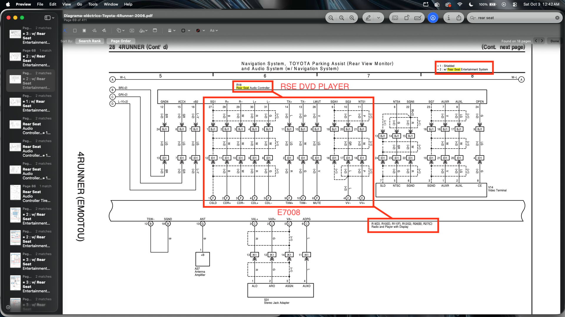

RSE DVD Player breakdown:
-The video in VV+ and VV- on the R27 plug (headunit side) take in a video signal from the RSE DVD and sends it into the NAV screen. It has nothing to do with telling the NAV that there is a dvd player installed
-The TX+, TX- (dvd player side) send AVC-LAN data into the TXM+ TXM- (headunit side)
-The CSLD,CDR+ CDR-, CDL+ CDL-, are all for audio going to the R11 port on the headunit
How RSE DVD Player works:
The factory RSE DVD player works this same way. The RSE DVD player sends a Toyota specific AVC-LAN data to the headunit through the TXM+ and TXM- pins and tells the car that it is a DVD player. The headunit sees this signal from the DVD player and decides that because it is a DVD player signal and NOT a cd changer signal, it will enable the RSE to send audio AND will enable the V+ and V- pins on the R27 port for the rear screen video input. So now once you click on the "DISC-AUX" button and cycle through the sources it will go through the cd changer and then it will change to the RSE DVD input allowing audio AND video to pass though the headunit and display onto the NAV screen.
CarPlay Issue:
Because I want to use the rear screen video input (VV+ and VV- on E7008 R27) as the way to get the carplay box output to show on the NAV screen I need a way to trick the headunit into thinking that it has a RSE DVD player installed, thus enabling the RSE DVD screen input as well as audio to appear when clicking on "DISC-AUX" button. However there is no place I can find that tells me what specific AVC-LAN data the headunit need to see to recognize that there is a DVD player connected, only thing I could find online is the cd changer data.
I need anyone to help figure out what data the E7008 recognizes as the RSE DVD player. With this info I can create a fake RSE DVD player signal to the E7008 tricking it to thinking the RSE DVD player is installed and enabling the audio and video source where then I can inject the carplay box into the E7008.
PLEASE if anyone knows anything help me out. I am so close to pulling this off I just need these final pieces.

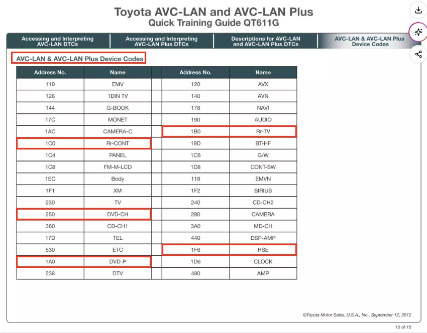

Update:
Here is some useful AVC-LAN and AVC-LAN Plus codes. Im not entirely sure what the codes mean, how they work, or how to replicate them (any help would be appreciated). Seems like there are multiple DVD player addresses that the headunits can recognize. Im guessing these are for different models of DVD players from the Sequoia, Sienna, etc.
Full Toyota AVC-LAN and AVC-LAN Plus Guide here.

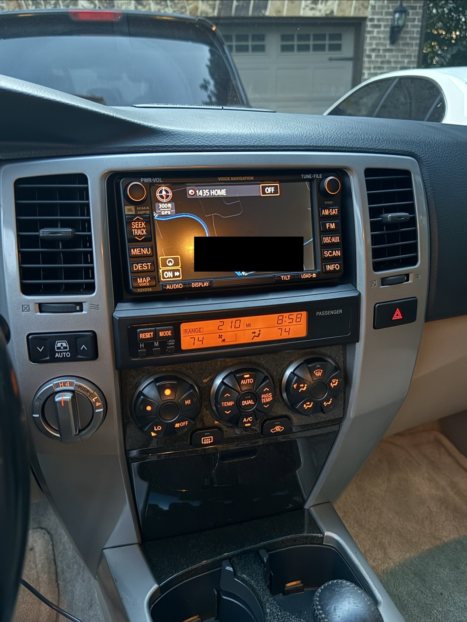

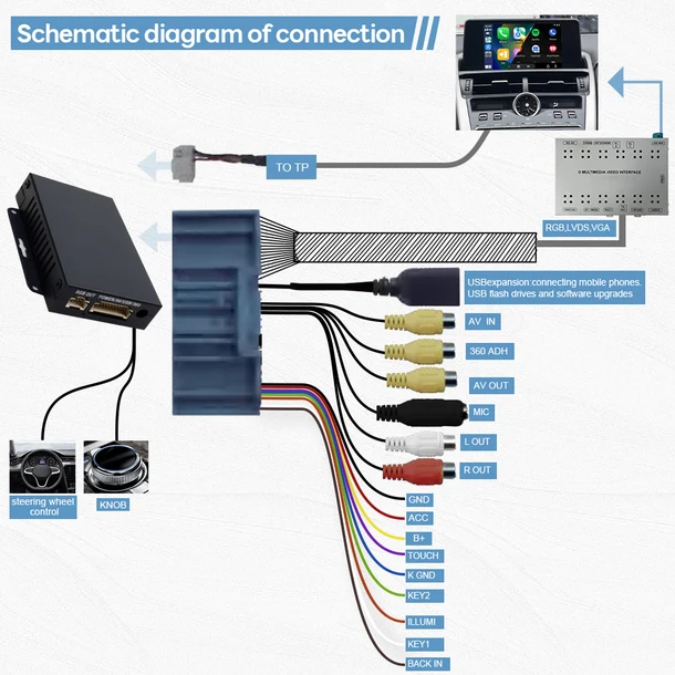

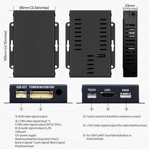

Carplay Works!
Turns out all that research was not that useful lmao.
The carplay box I showed earlier that I was planning to make my own harness and stuff to make work with the e7008 apparently already comes with everything needed.
it is basically plug and play however you do need to take the display apart and mess with the display and touch ribbon cables. Anyone can easily mess up and waste 200 dollars plus possibly break the head unit itself. I've got it working on mine and its amazing, full touchscreen functionality, decent audio quality, zero lag, back up camera support, wireless carplay or android auto. It also has basic Bluetooth functionality and screen mirroring. Does keep factory software, there is a button to switch between. This is definitely worth it if you know how to install it properly or have somebody who can. (yes the screen can still flip up and down for the cd player. I assume this works on many other Toyota head units with the flip down screen from many generations.
Although I have not seen any documentation on this product anywhere online so i guess this thread is not completely useless lol.
Carplay box (Exploter) - (link)
If anyone would like I can share the install process.
