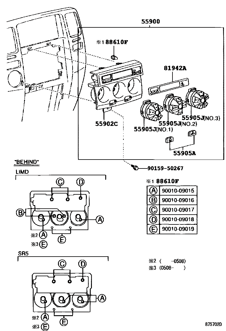

Does anyone have a part number to those two replacement bulbs? I'd prefer to order online than to drive to the dealer and pay their prices.

I believe the SR5 and Limited are different. My limited has two bumps for the middle temp control. Can anyone clarify?
Yes, the limited does have 2 lights in the middle temp control
Just replace nine bulbs in mine. Mostly HVAC screen and two switches. The biggest pain was getting all the part numbers.
