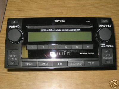

~ Will this system fit in my 2003 Sport Edition?
~ It looks kinda small compared to the OEM that is in there now, too bad there is no tape player.

It will not work. The one in the picture requires a digital external amplifier and since you do not have a JBL system, the amplifier and wiring is not there. Also, the dash opening is a different size (it's a bit wider on the bottom than the top).
The Scion H/U is plug and play if you do not have the JBL. It's one of my favorite mods and also very inexpensive. :biggrin2:

To answer your question for the JBL, as mentioned above it will not fit, for the scion pioneer on the other hand it would be a direct swap for your radio.. i have it on my 4runner.:)
