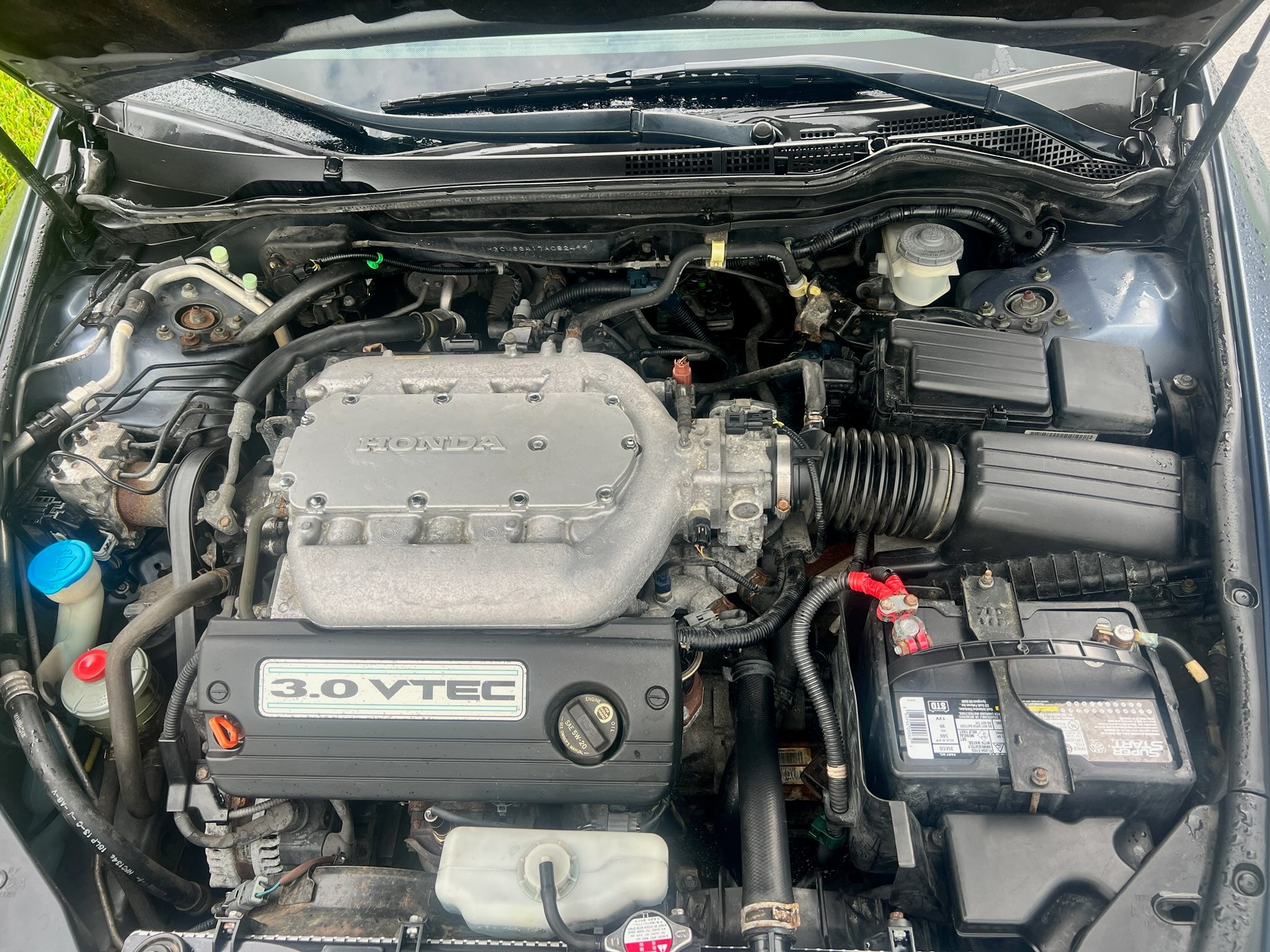

Photo of the engine bay, taken 8/28/23

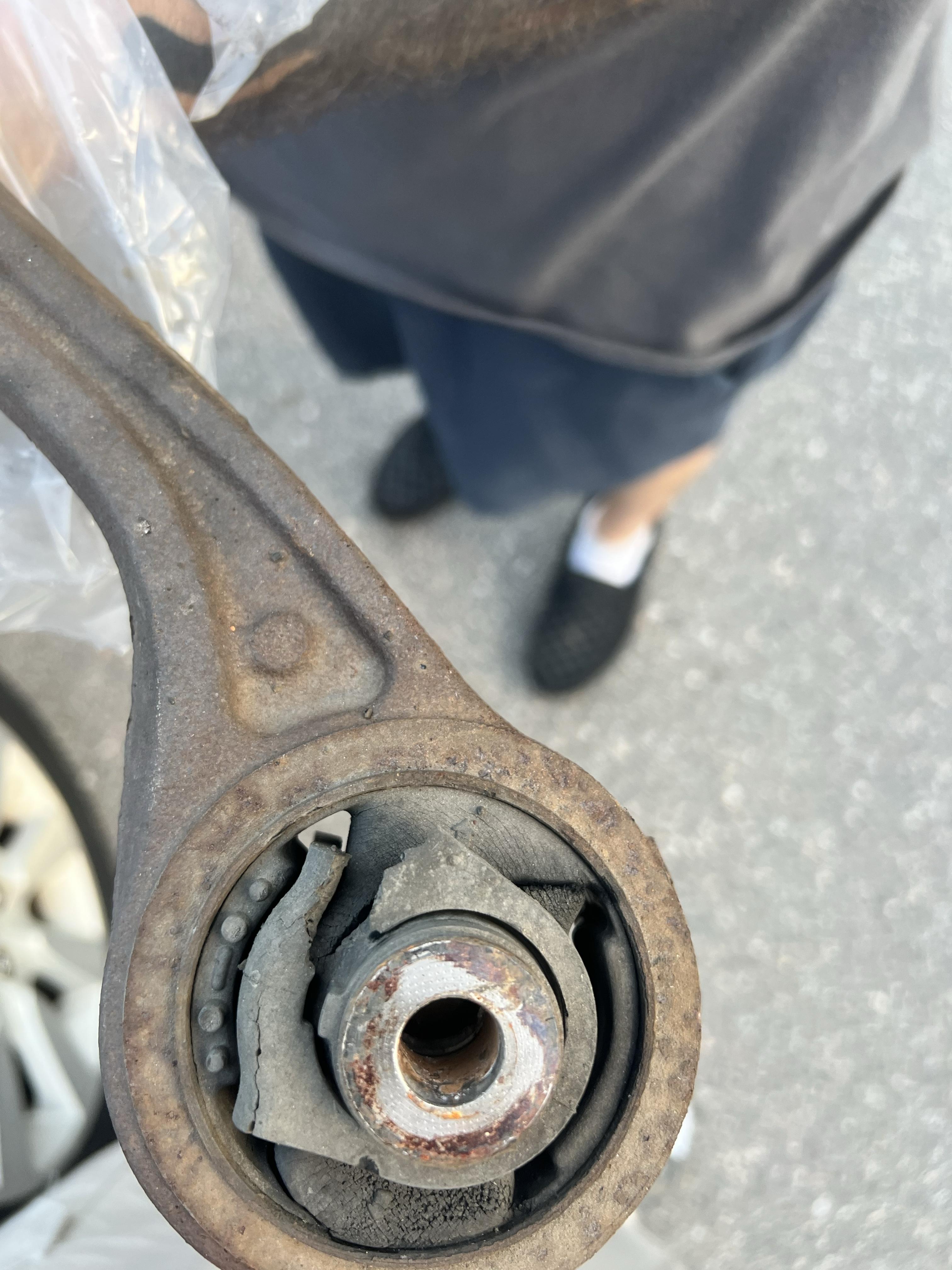

Here’s a photo of the original upper control arm that was removed. Bushing was shot.

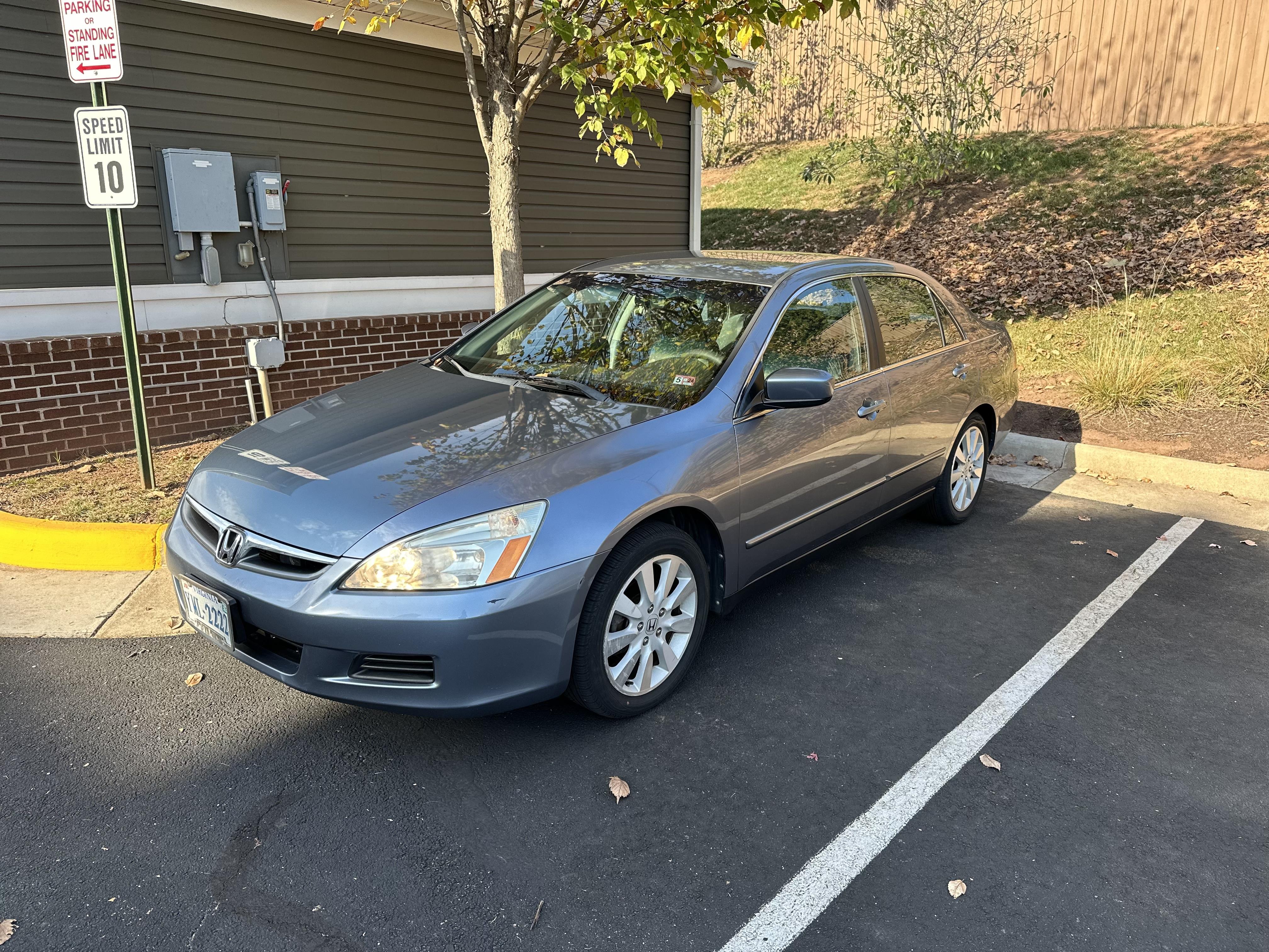

The Accord has arrived! Man does this thing drive & ride smooth compared to the 4Runner. It’s clean inside and out and is really, really nice. I have some things lined up for it this week, so further updates to come then.

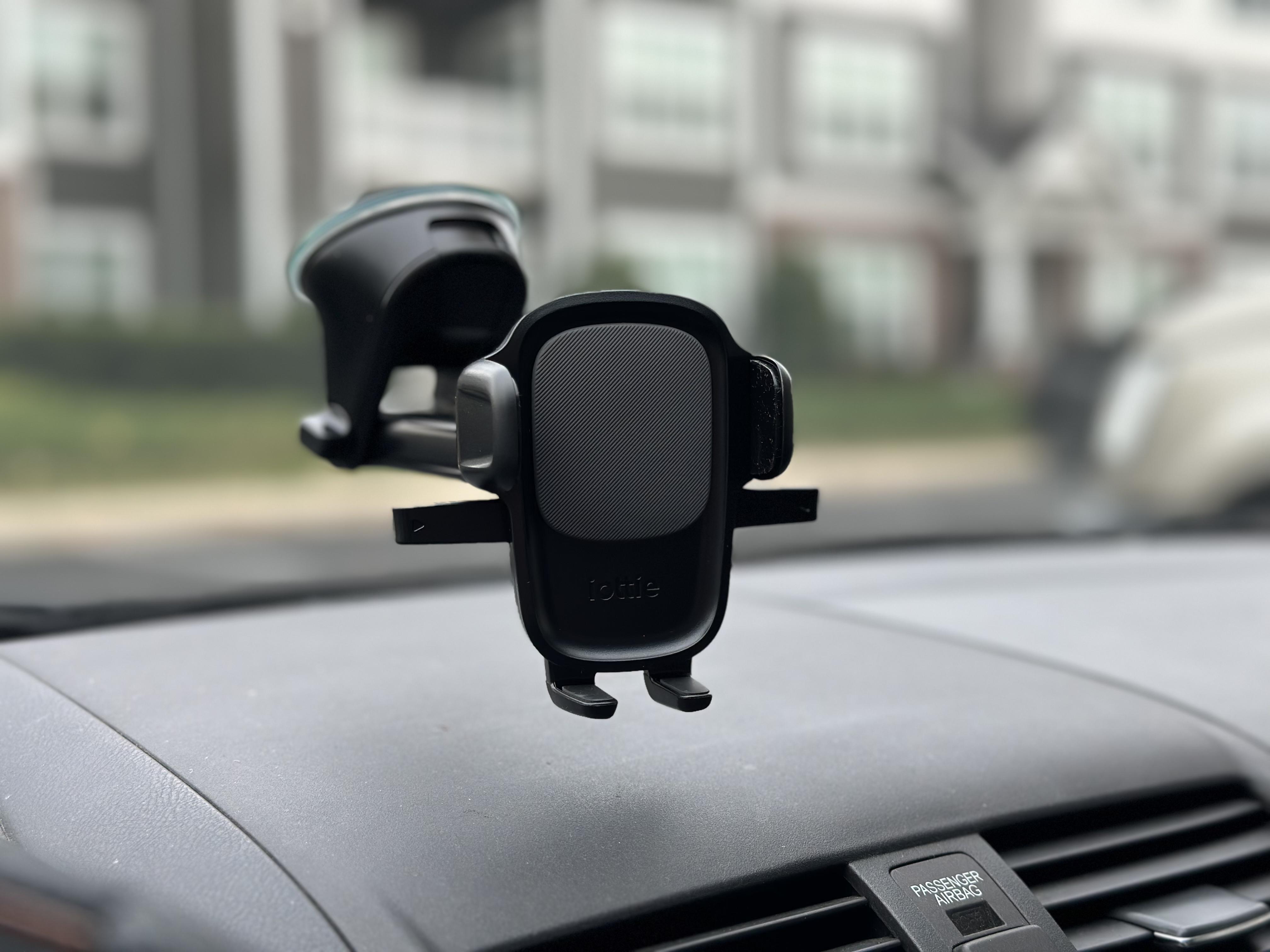

First things first, I’ve gotta have an iOttie phone mount. I’ve had one in the 4Runner for about a year now and I couldn’t drive without it. It makes GPS operation and phone calls a breeze without having to take your hands off the steering wheel. Must have. And they’re super affordable, too.

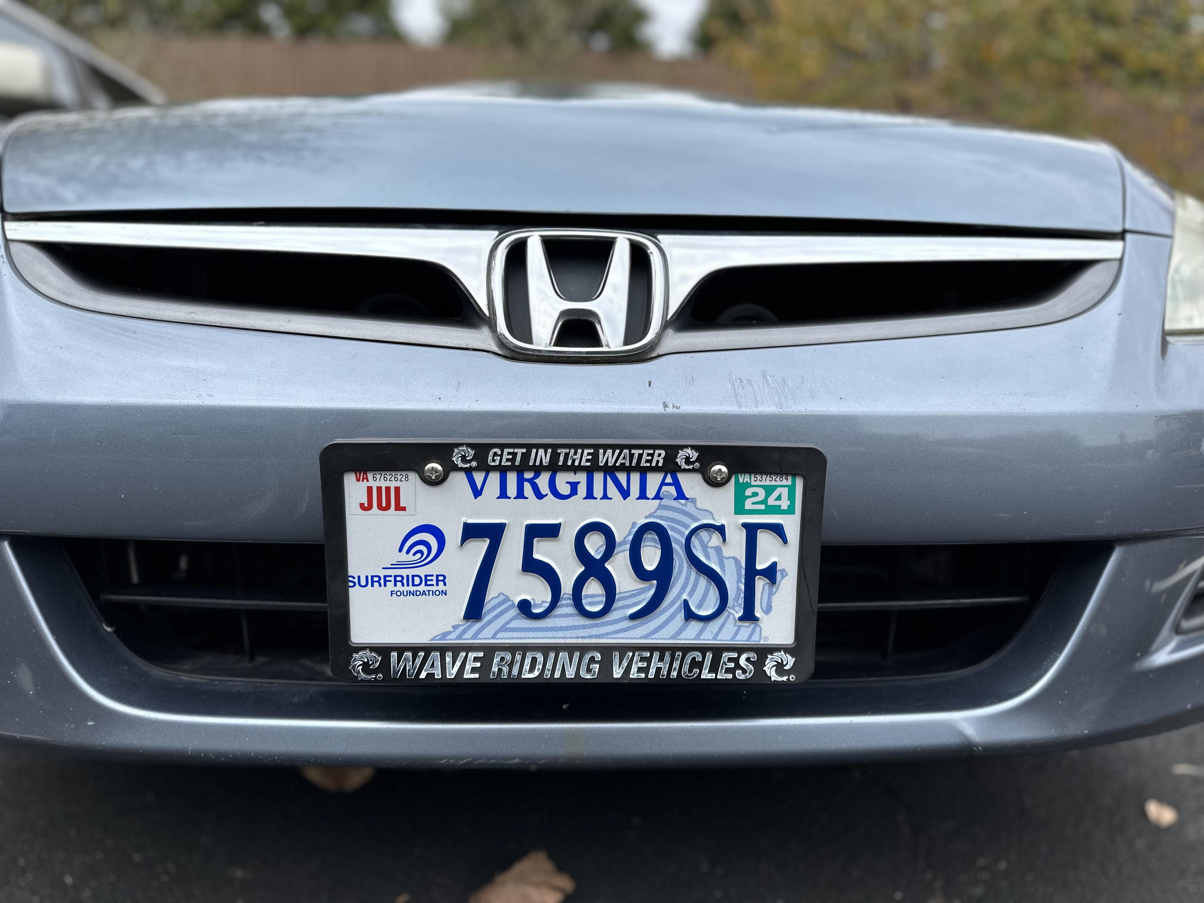

New hardware for the license plate mount. The old screws were extremely rusty and I was concerned about stripping them out. The little details matter. And it’s funny, as I’ve begun to embark on this new journey with the Accord, I’ve really truly realized how much work I’ve done to the 4Runner over the past almost 11 years. It’s pretty wild to think. So this is only the beginning.
Looks great, congratulations on paying less for fuel! Rode around in one in college since a friend had one (maybe an 07?) - second engine but it was up there around Cookie's mileage if I recall correctly.
Thanks brother. I haven’t even gone through an entire tank of gas yet. I’ve only been driving it since Sunday. To and from work and around town. It’s doing great. I’m super stoked to have a new project.

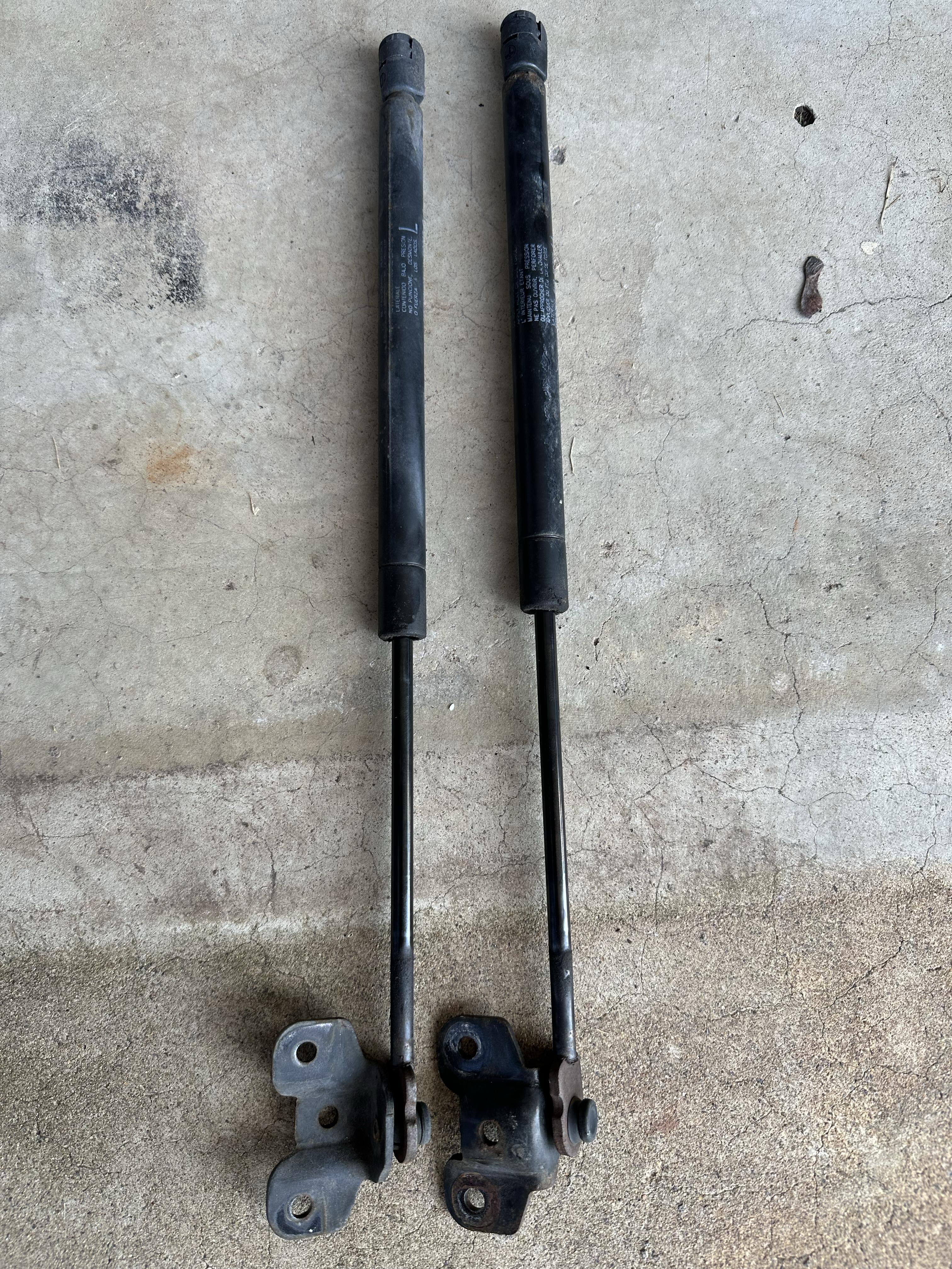

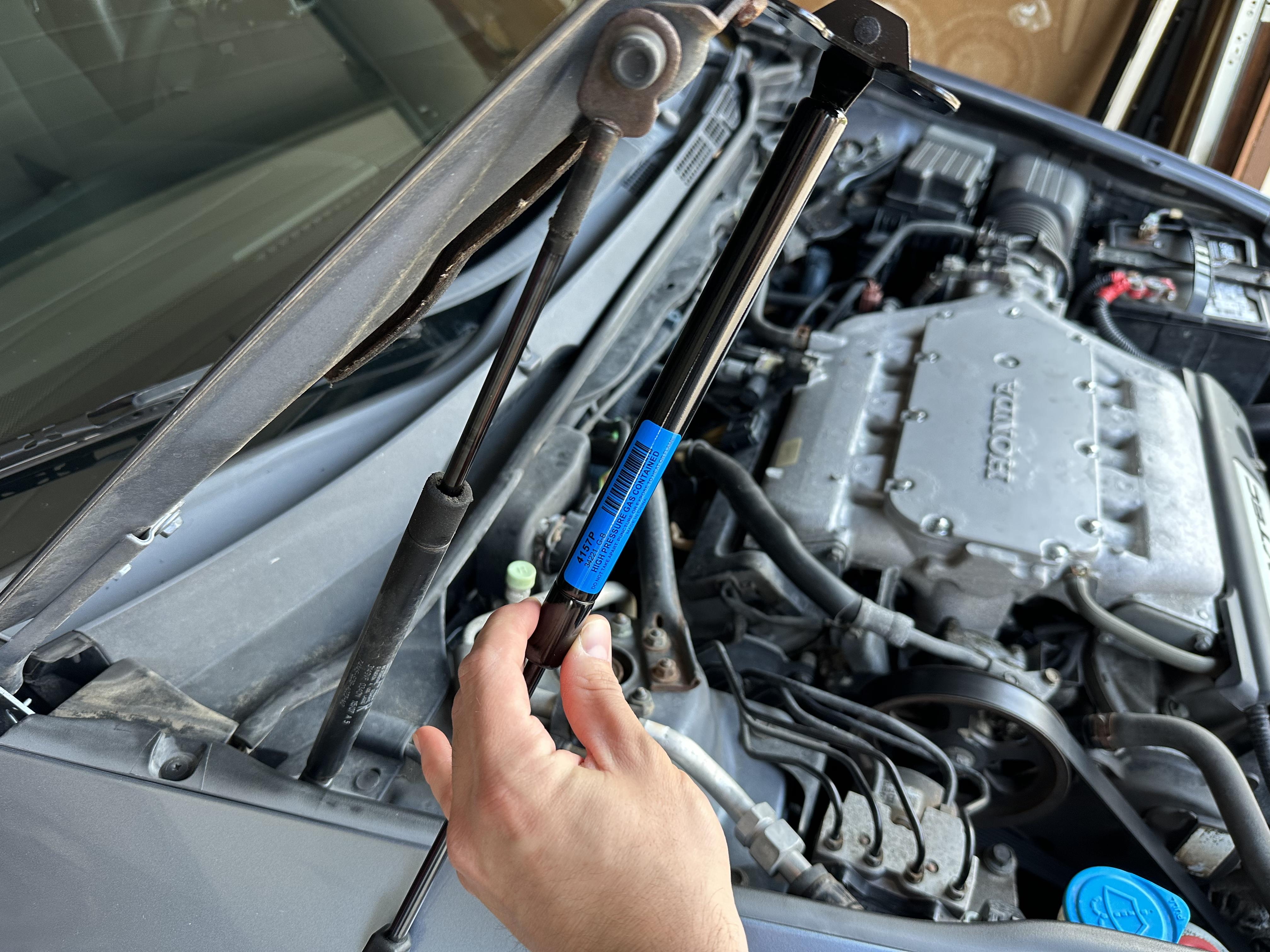

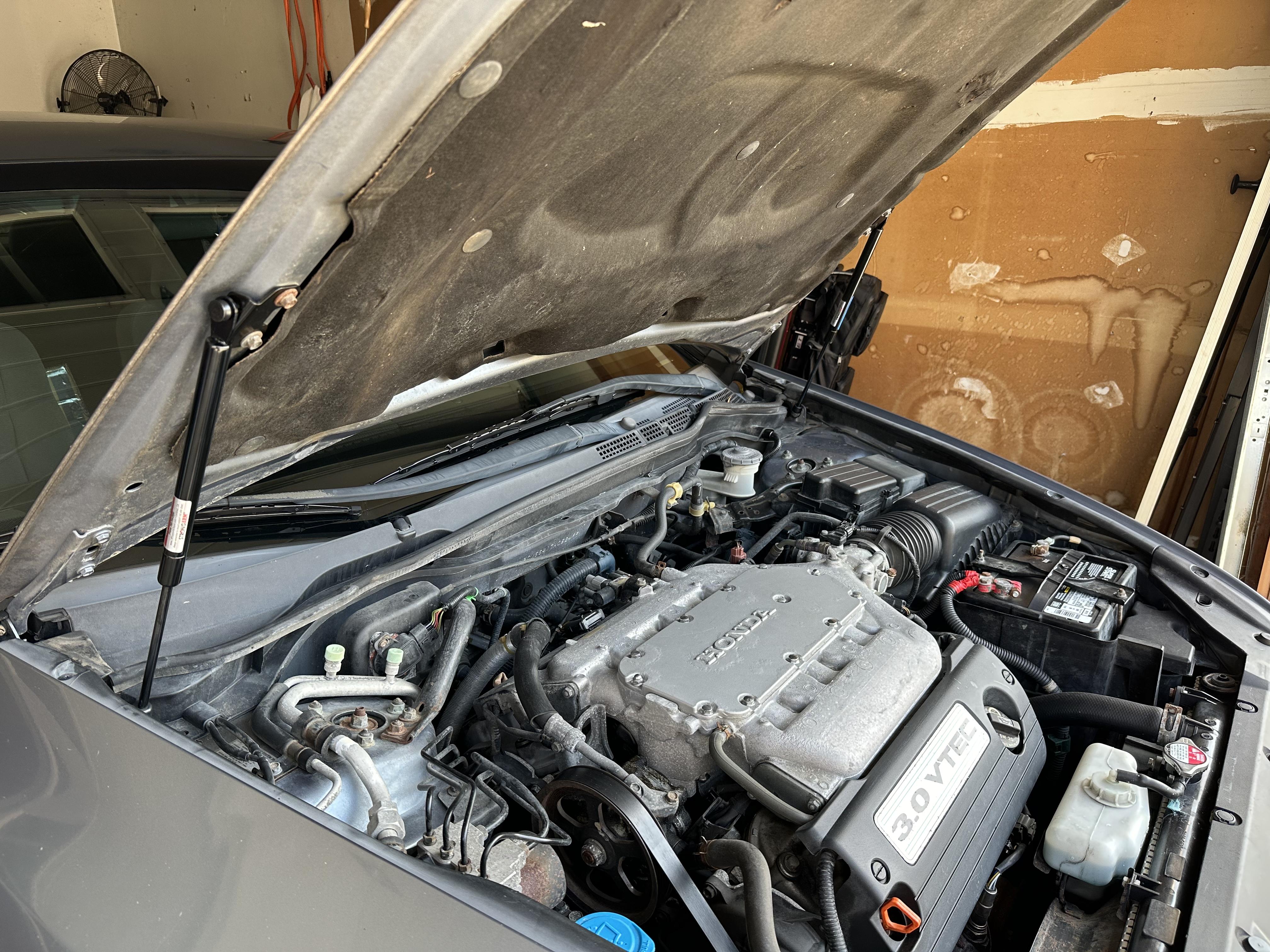

Accomplished quite a bit today. The first order of business was to replace the hood struts. My parents bought these for me a few months back and have been in the closet waiting for installation. They’re the Strongarm brand which is the same brand of struts I have on the rear hatch of the 4Runner.
After installation the hood popped right up and open. Nice and smooth. It still had the original struts on it and they were completely worn out. Wouldn’t even hold the hood open. Problem solved!

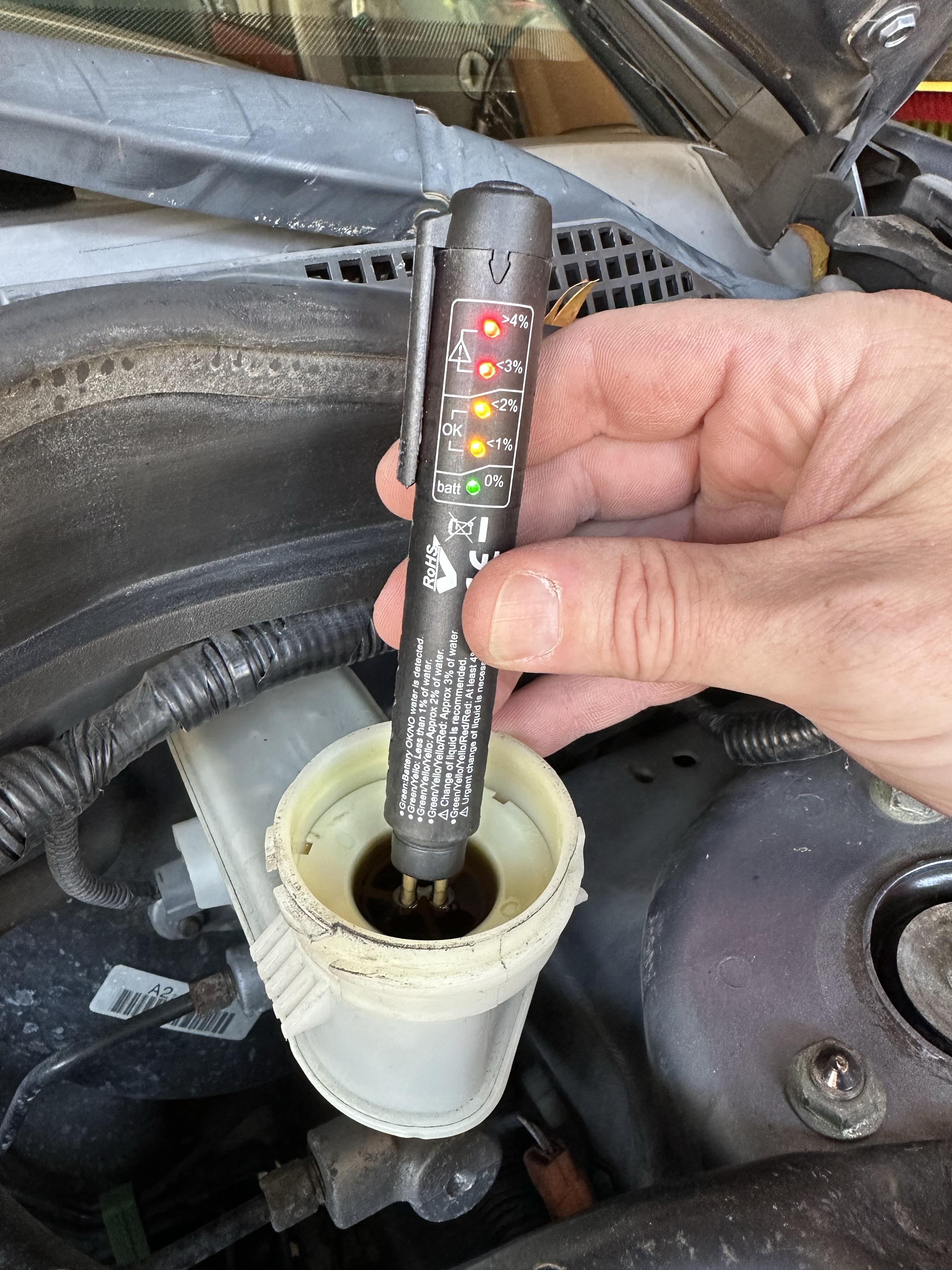

My buddy has a brake fluid gauge/tool/reader thing. Evidently the fluid is in bad shape and has 4% or more water/condensation in it. So, that’s gotta get done asap.

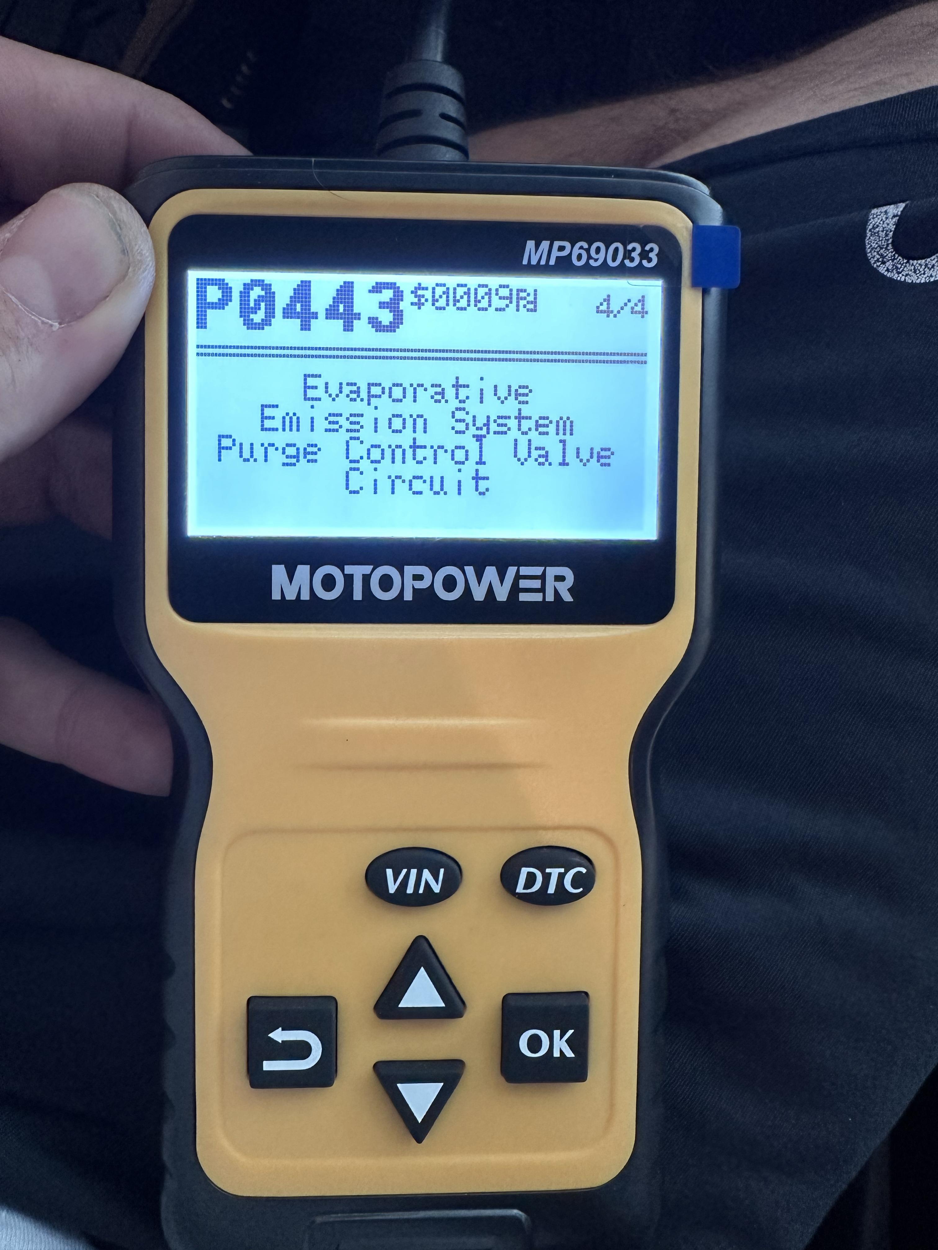

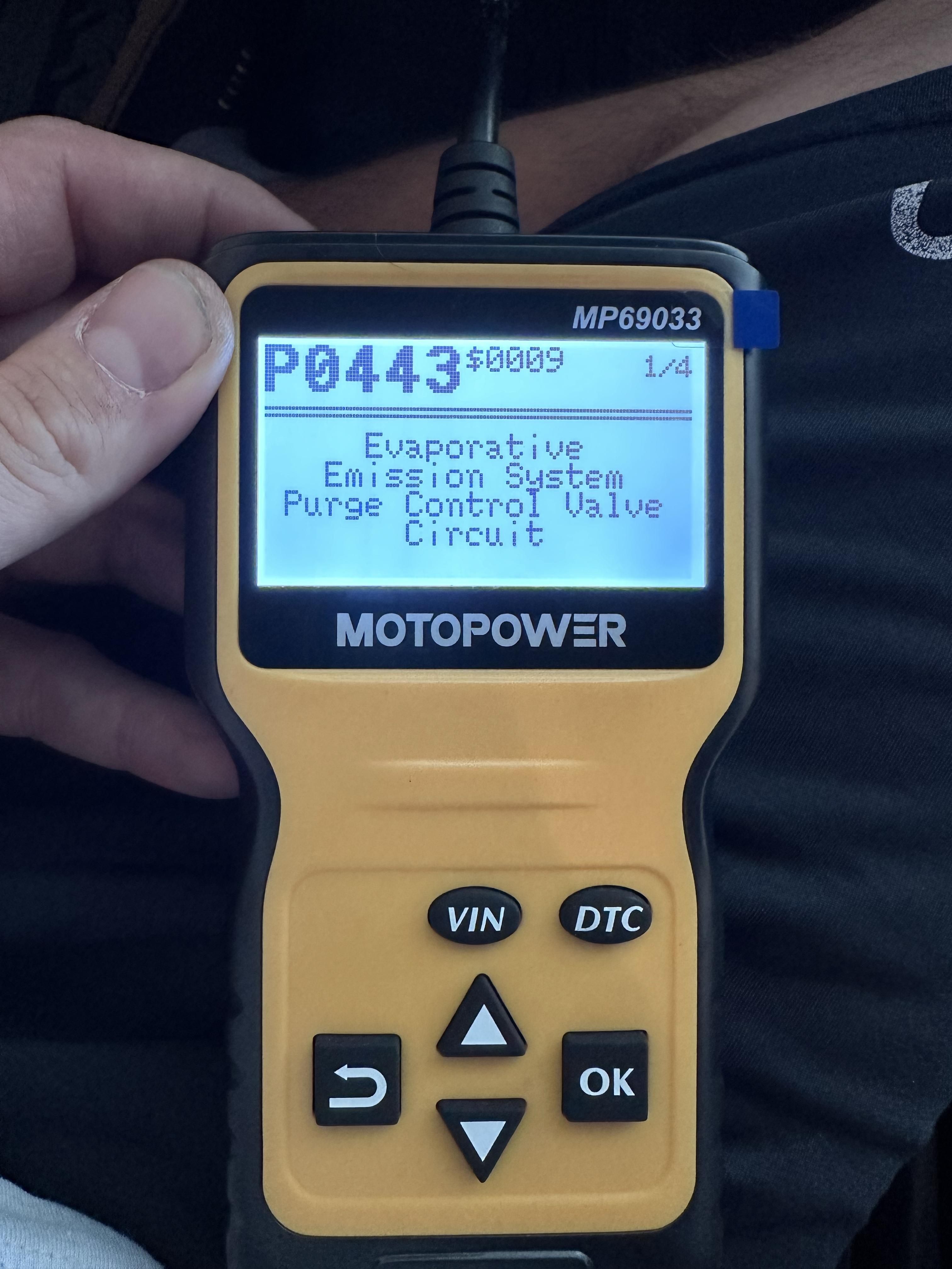

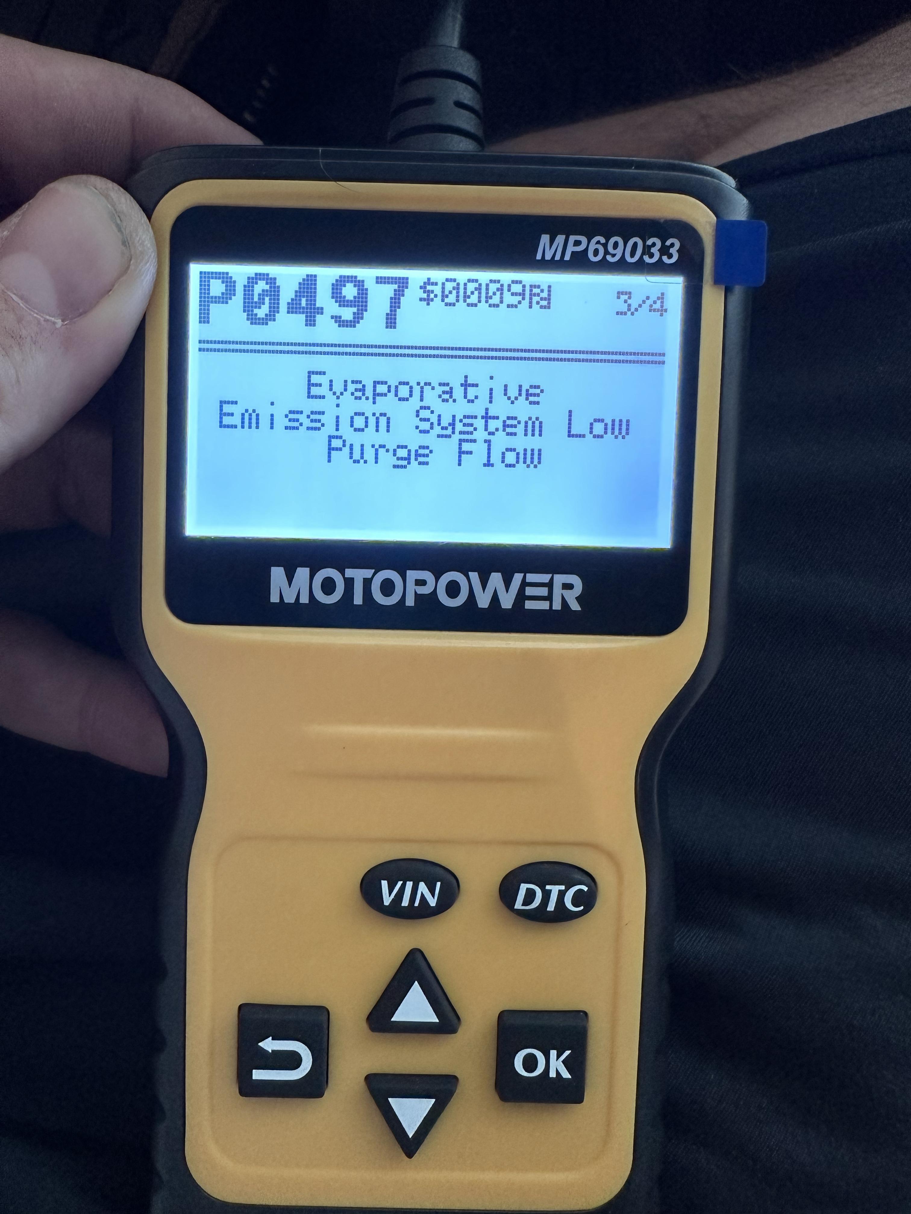

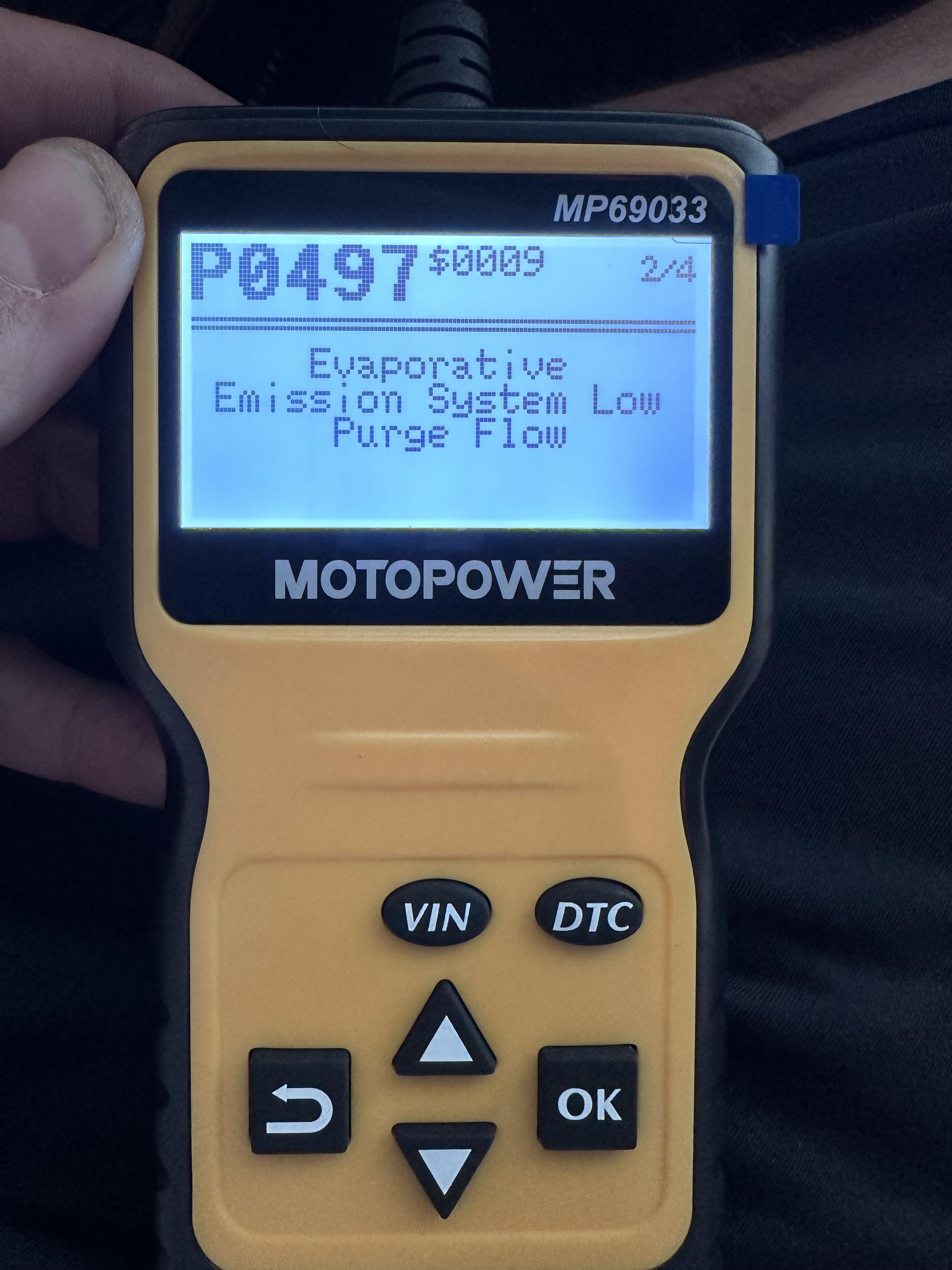

Since the check engine light was on it was necessary to pull the codes. They read as shown below. I’ll have to do some research on them this week to find out what all I need to do to get them fixed. I ended up erasing the codes and drove around for about 30 minutes in total and the codes ended up coming back on. So clearly they are relevant and pressing.
