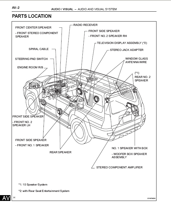

Can someone who's had this apart (panels ,etc.)
tell me what are the location, sizes, etc of the factory speakers in a new 4R?

That's going to depend on whether or not you have the 10 speaker or 6 speaker system.
This PDF's show the exact location of all speakers and how to install or disassemble panels to reach them. The PDF's might not necessarily in order, so you might want to open them and order them by page number as they appear in the Repair Manual.
Speaker Locations (PDF's)
Found this diagram in the Repair Manual
