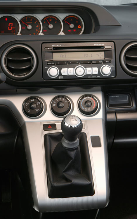

check out the new 2008 scion radio. Looks like another direct install into the 4runner.
Dont know what the premium looks like, but sounds cool.
Standard iPod Connectivity
Apple iPod connectivity is standard across the Scion lineup for 2008. Scion's standard 160-watt maximum output Pioneer AM/FM/CD audio system features a head unit with iPod control. This head unit integrates track, artist and album information from the iPod into a one-line display on the head unit's screen. Connectivity is achieved by simply plugging the iPod into a port via a connector cable, providing outstanding sound quality through the car's stereo system and constant power to the iPod. Music is controlled through the head unit and steering wheel audio controls. A standard mini-jack port also allows users to listen to their portable music collection through the tC's Pioneer speakers.
Since many Scion customers add in-car entertainment systems to their vehicle, the tC comes standard with rear head unit outputs allowing for the addition of external amps to boost power to the front and rear speakers, and subwoofers.
The tC's optional premium audio system adds one more feature to the standard head unit, the ability to download "skins" to play on the LCD faceplate. Customers can download images, four-second video clips and eight-second movies from Pioneer's website. In addition, Pioneer software allows customers to burn their own images and movies onto a CD and upload them onto the available head unit.
Both the standard and premium head units retain key Scion audio system features such as Scion Sound Processing (SSP) where listeners can choose from three pre-set equalizer settings, satellite radio compatibility, a user-customizable welcome screen, MP3 and WMA capability, Automatic Sound Leveling (ASL) and Sound Retouch Technology (SRT), which provides clearer CD sound quality. Both systems will also feature six speakers: two tweeters and speakers in each door panel.

It's my understanding the new Xb is larger too.
We need to know if this new radio is "plug and play" for the 4Runner since it has ipod capabilities!
there is at least one long scion ipod thread that says if the scion radio is plug and play in the 4runner, that full ipod connectivity is problematic because of one cable that is part of the scion wiring harness that is not present in the 4runner.
guys managed to figure the pinout of the connectors and made their own cables.
a search should be done to find that thread here.
Scion missing cable
I have found a source for this cable that connects the Scion headunit with the iPod option to the other cables.
I have purchased on myself to use in my Rav4 and it works great.
I found iit on ebay under "SC12234".
Any questions about its use I will try to answer.

What an awesome system!!!
I'm really interested if that unit will fit into my 2000 Limited. Any word on prices if it were too.
Also I currently have an amp and sub hooked, would that work with the Scion unit?
It should drop right in to the 4th gen runners...
Will not fit in a 3rd gen without modification of the dash.
Metra calls for the same dash kit for the 08 Scion as it does for the 4th gen 4runners, and the wiring harness is a standard 2 plug toyota harness. No amps and nothing tricky.
So if you have the basic non-jbl stereo... It'll be plug and play. If you have JBL, you can make it work but you'll have to rig something up.
