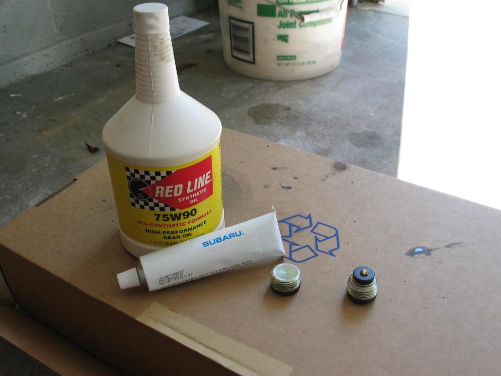

Some time ago i did rear dif on my 2006 WRX and it has liquid gasket instead of crash washer
