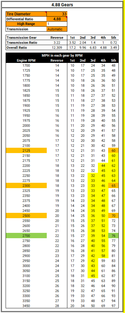

Below is a gear mapping to speed calculations with the 4.88 gears.
My question, will this build comfortably tow on this trip.

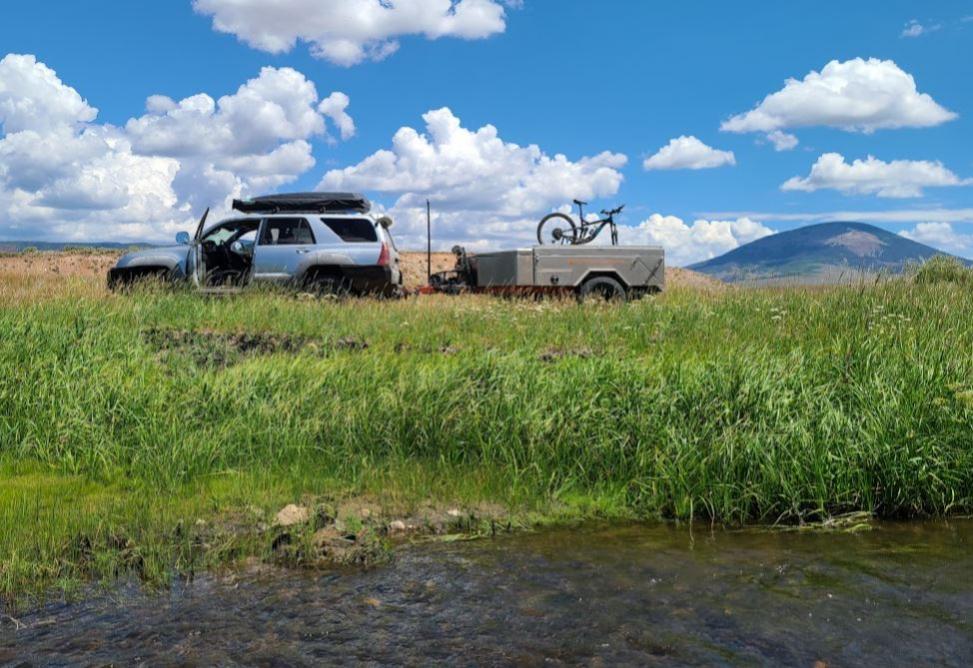

Congrats on the upcoming retirement fella!! I applaud your attention to details, and I think your rig may not like towing the length and the weight of your trailer over that distance. My concern is for the safety of you and other motorists around you. This trip is going to be massive and my *assumption* is that you're going with a hard sided trailer. Your tow rig is dinky, for lack of a better word. That's a lot of hwy with lots of cross wind that will absolutely tire/stress you out with a 4runner. You'll be a very active driver with that trailer, and sway control could possibly exhaust you.
Just for reference, I have a dinky Australian popup with a 400# tongue weight, and a wet weight of 2600#s. My V8 tows it with ease due to the very little air drag, so I'm trying to imagine a heavier trailer with a large form factor. I have Air Lift 1000 air bags inside the rear coils for the times I'm towing this trailer. I assumed a large form factor due to the 500# tongue weight you're envisioning.
Again, congrats on the big life change and the awesome trip that's upcoming.

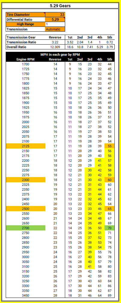

Just one more thought, I could also go 5.29 gears, a little more RPMs, a little slower:

Thanks for the spread sheet.

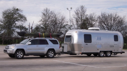

You don't mention if the trailer is travel trailer or gear trailer. Tongue weight is the challenge because the 4WD maxes out at 700 lbs., which includes the hitch weight. Even that depends on if you have propane tanks and if they are filled. Batteries are also additional weight. You want 60% of the weight in front of the axle(s) and 40% behind or you'll have uncontrolled sway in an emergency situation.
I pull a 23' Airstream that maxes out at 6500 lbs. When I take it to storage it has the propane tanks mostly filled, has the kitchen stuff, blankets, gear for the campsite etc. Holding and fresh water tanks are empty. There is no food or water, clothing, TVs, miscellaneous comfort gear etc. The tongue weight is 730 lbs. at that point. I use an Equalizer WD hitch to offset the hitch weight when I add in the food, clothing and other gear.
I have traveled from KY to OR across the middle US route, returned across the north route and down through MN, IL, IN to KY. I have traveled to D.C. and down to FL and across to TX. My '04 handles very well but headwinds are a problem. With a strong headwind (at least with a travel trailer) I can go 60, 65 in a pinch. With no headwind or even a tailwind I travel at 70, except through the mountains. Then my speed will drop to 50-55. I get 9-13 MPG depending on the wind. On the trip out to OR it was a headwind both ways; not fun.
You don't say what your experience is with towing a large trailer. I've towed box trailers and boat trailers but the travel trailer was a big change. You want to get some miles under your belt if you've not towed anything that big.
