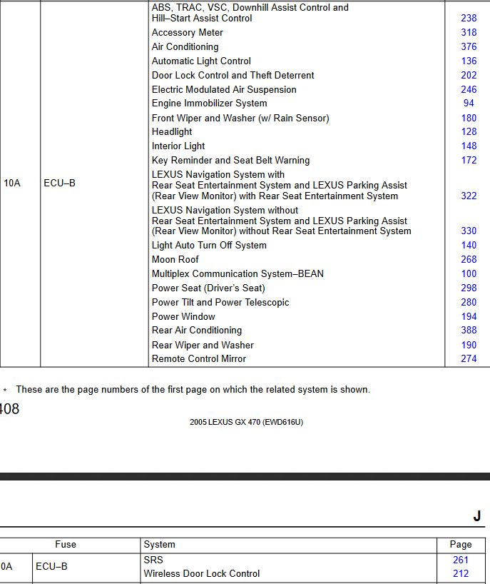

They seem to be correct about operating a lot of electronics, see below. I can't find a good schematic of everything it runs, but it looks like it's pretty much any White / Red stripe wire in the car.
I'd start by disconnecting components one by one until you find the offender. Alternately you could take a current clamp, and find any white / red wire with current flow to find the offending circuit.
Good luck!
-Rob
Good luck!
-Rob
