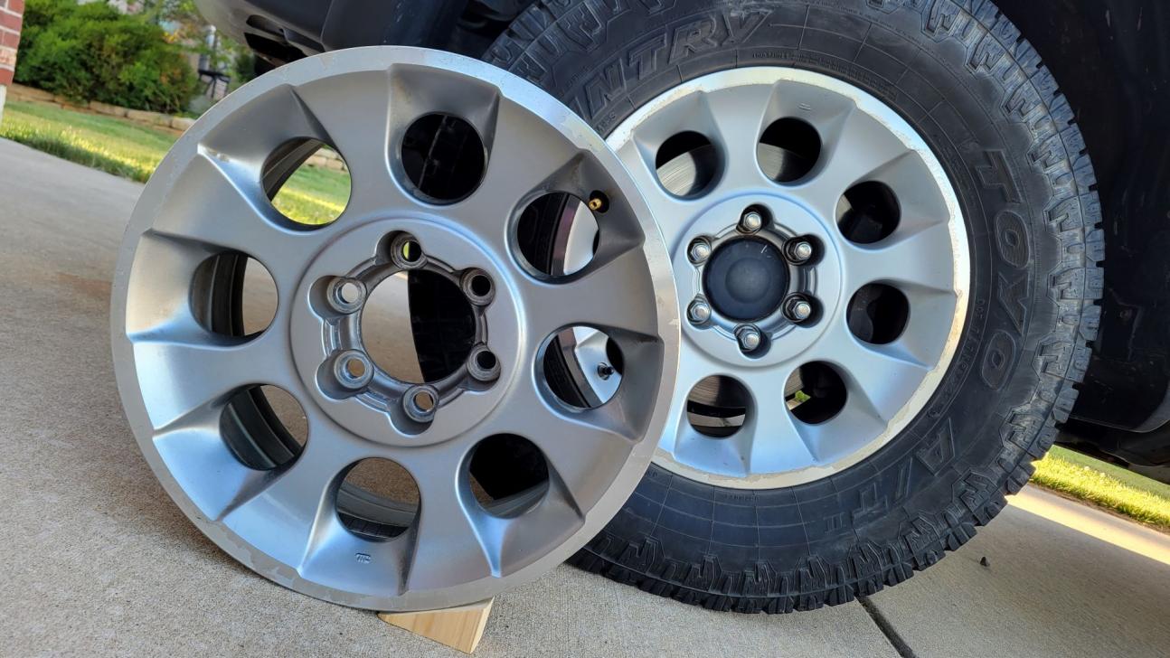

Banged up one of my OEM Trail Edition wheels and found one on ebay that was listed as 2010-2013 Trail Edition wheel. When it arrived it was a darker gray metallic color and isn't anywhere close to the original wheel color.
I seem to remember seeing this gray metallic on FJ Cruisers, or maybe later 4Runners.
If someone could enlighten me as to what the darker gray metallic wheels came on, I'd appreciate it. I need to make sure I have that info for when I contact the seller to return it in case he claims it's the correct one.

There are two different Toyota part numbers for these rims.
42611-35420
42611-35410
I'm not sure which of these is for the lighter color version and which is for the darker color version. Might want to check the inside of your rims (originals and newly purchased) for stamped codes.
Yes! Thank you! The charcoal color is what I received, not the Silver i have on the 4Runner.
Do you know anything about Originalwheels.com? Are they legit?
Any experience w/ Original Wheels?
Also, I think the PN is 42611-35420 from what I found online for the 4runner wheels
