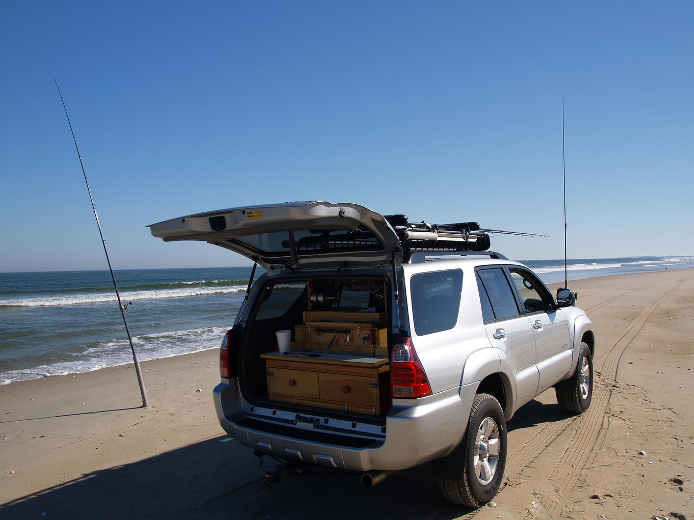

I start at 20psi and in the summer have gone to 12psi in the soft coquina sand.
Jarvis at cape point exxon loves to come and get you unstuck, but have a thick wallet. Join the beach buggy assoc.great tips there.PB024607.jpg

So do you think the limited will get me where I want to go at Hatteras? I would absolutely love to do exactly what you have pictured!!!
If the beach at Hatteras looks like that, I'm sure it will. Like I said, I'd go with 17 or 18 wheels in place of the 20's. He and I both have 4th gen 4Runners, and the 5th Gen Limited has basically the same 4WD system and similar ground clearance. The only difference is the 20" wheels on the 5th Gen Limited.

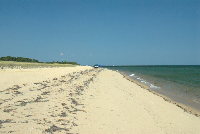

This part of Chappy is quite soft, but I've never had any problem there:
Just use some common sense. Park above high tide. If there aren't tire tracks where you want to go, there's probably a reason, so don't go there. If you start to bog down, stop and try to back up the way you came. Use slow inputs -- brake slowly, accelerate slowly, turn gently.

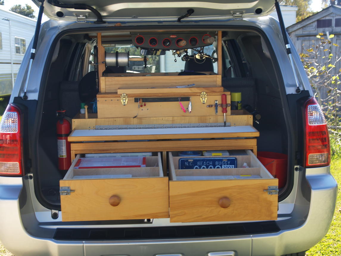

kinnakeettom: darn nice tackle station. You make that yourself?
no fish biting in the winter so drew up the plans and built it.
Out grown it and have ordered an adventure 4x4 trailer that will hold even more.
