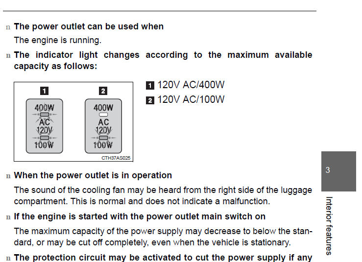

I have a 2010 Toyota 4Runner LTD and I noticed something interesting. When I press the button to turn on the a/c (electrical 110) outlets in my truck, both lights come on indicating 100w/400w while in PARK. This is normal. When I press the button while driving, the GREEN 400w light comes on. Now, according to the owners manual, 400w is ONLY available when the car is in PARK or NEUTRAL. Therefore, it should NOT be coming on while driving. When I press it while driving, I expect the yellow "AMBER" light to come on. I've contacted my local Toyota dealer and I'm going in this Saturday to have this checked out. I was just curious if anyone else is seeing this? I'm just concerned I may have some sort of wierd electrical issue. I don't plan on using the outlets anymore until I get it checked out. I'm just an "OCD" type guy, and I knew it was wierd because I remember the dealer telling me that 400watts was only available when you weren't driving.

I checked on my TE. When I start it and push the switch, both amber and green lights turn on. When I shift out of park, only the green remains lit.
My laptop charger pulls 120W and also confirms that shifting out of park drops the 400W plug in the center console to 100W, as indicated by the laptop switching to the battery indicator from the charging indicator.
Based on the information printed on the switch, I think they either misprinted the switch or the indicator lights are wired backwards.

I went to the Toyota dealer this morning. They did several electrical checks, and determined that I am only getting 100w while in Drive. They agree that the LED is incorrect and is likely wired incorrectly. The power system is performing as it should, it's just "misindicating". They have opened a ticket with Toyota Technical and will contact me when a fix is available.
They had another 4Runner 2010 come in for an oil change while I was there, and we observed the same issue on that one.
So, we don't need to worry about the power as it's correct. Just wanted to post an update. Looks like I found a bug, but nothing to worry about.
