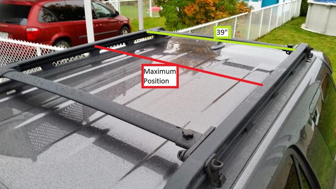

Hi guys, I've bought my 4Runner back in july and since then I have an issue with my factory crossbars. Here's the breakdown:
  • 2010 Canadian TE
  • Factory roof rack
  • Factory crossbars
  • Both crossbar are the same length
  • Both crossbar have the word Front on them
The issue is that I cannot move the rear crossbars all the way to the back, it get stuck in the middle has the roof rails are not parallel (they shouldn't be) but the cross bar just cannot fit between the. The PO told me that he never used them as he had a Thule setup over the roof rails.
I've unbolt the roof rails, trying to get them apart, but with a slight improvement only.
I've read countless threads without finding anyting useful. Even some poster in this thread are saying that the have a front and rear crossbar (written on them) or both Front and some have same length crossbars or others have different length crossbars. I'm really confuse about this, I even went to the dealer and the part guy didn't have a clue and cannot find any info in his system.
Any clues or confirmed information about the crossbars lenght will be appreciated.
I've measured the distance between the roof rails at the rear and they are about 39" apart. The red line is the maximum position I can go or it will lift/pry the roof rails from the roof itself(This is not my truck BTW).

I've measured and took some photos (truck is dirty).
1st Pic: This is my current setup, the rear crossbar is where it's start to pry the side rails. the inner dimension (from the inside on the side rails to the other:
  • Front crossbar = 40"
  • Rear crossbar (current position) = 39 1/2"
  • Rear (where I wish my crossbar sit) = 39"
2nd pic: I've removed the crossbar adjusting nut and move the crossbar as far as I can. I cannot put back the nut as the hole is out from the slot. You can see the side rails prying.
3rd pic: A close up pic of the side rail, you can easily see the gap between the rail and the roof.
4th pic: I've removed the crossbar from the mount, move it to the rear of the rack ( [MENTION=78968]oljedi11950[/MENTION] the mount move freely from front to back). I've then try to put back the crossbar, but you can clearly see that I'm missing about 1/2" to make it fit.

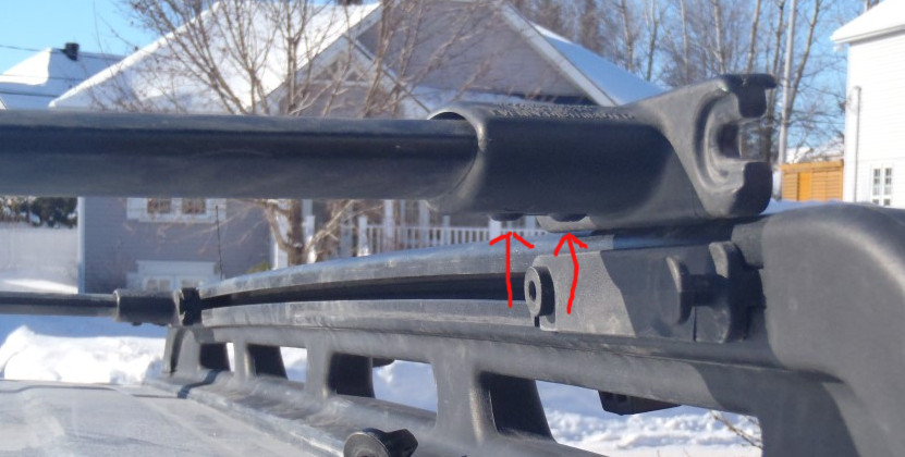

Just to double check, have you loosened the two bolts on the bottom of each side as shown by the red arrows here? I don't think they have much play but maybe enough to get it to fit.
When I installed mine, these bolts were loose, I think just on the passenger side. I didn't tighten them until after I had the bars positioned. I believe the crossbars were shipped with these bolts not installed (It was only about 3 weeks ago that I installed, them, you'd think I'd be able to remember that).
I've dissambled both crossbars and they do not have any play, but even if they have, it won't be enough.
