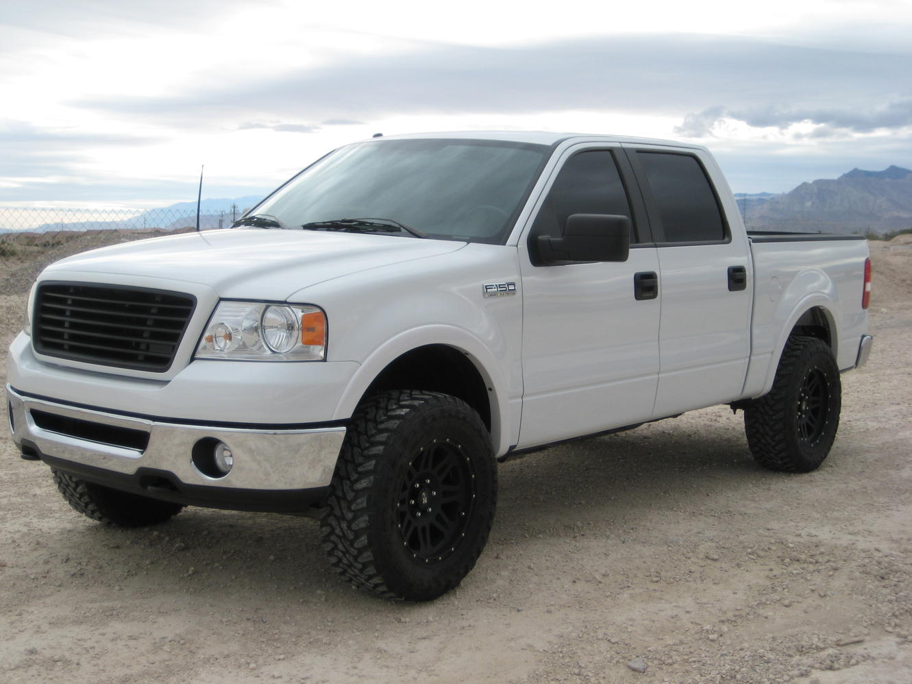

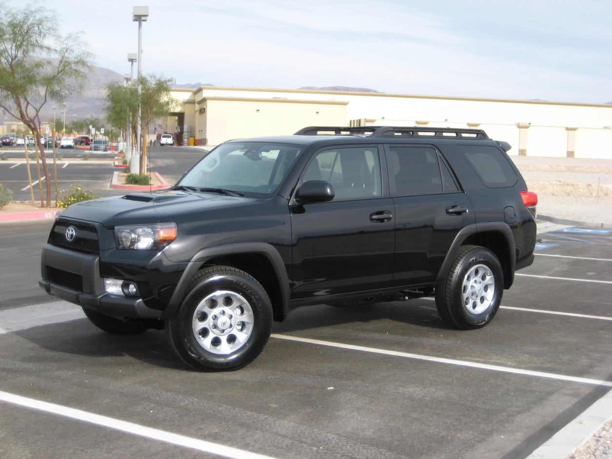

Are there any 2010s with mods out there? Looking to see some pics with upgraded wheels and tires. My girl just bought a TE and something has to be done with the stock wheels and tires. Tint is first on the list. Here's a pic of hers and of mine. BTW, the antenna has to go!

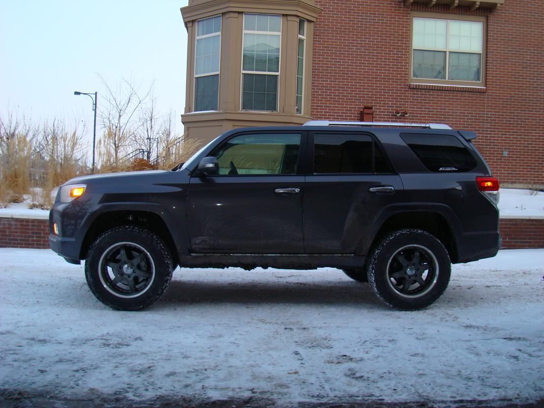

Tell us what lift you used. Also, what brand tires?
Toytec 3" spacer up front, 2" rear coils. The tires are Cooper Zeon LTZ's. 275/60R20. I have never run them before but heard good things so we shall see. They are quiet on the road, and have handled good so far in the snow.
BFLAN.....how did you remove the emblem?
The emblems are just stuck on with double sided tape. I heated them up a little with a heat gun and then just pulled them off. Cleaned off the residual with some bug off. Very easy!
