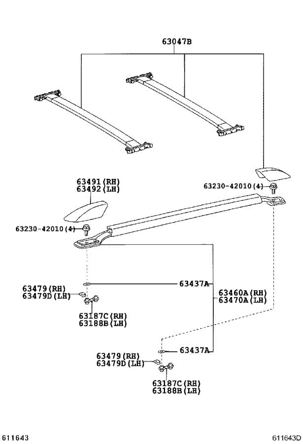

I also took apart the railing system and cleaned underneath it, lots of debris there. I ordered 8 new weather gaskets for the 8 bolts that hold it on. They looked worn. They are only $1.50 a piece, so why not. I’m planning on adding a dab of silicone on top of them once I replace them.
I know it's been a while, but any idea what the part number is? Is it 63437A?

Lots of threads on reasons not to use silicone as certain kinds shrink months or years later and/or create a chemical reaction with paint resulting in rust. Butyl rubber is best. Roof rack mounting bolt leaks will also result in wet seat belts. Sometimes not so noticeable- pull those babies out to the stops and check for wet/damp after a big rain or run the hose on it.
