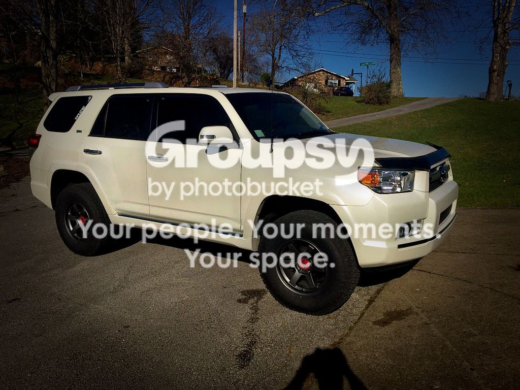

Here is the vehicle, a 2012 Toyota 4Runner with a small lift and some aftermarket wheels and tires.

Oh hey - Didn't see lowcel was the OP! Howdy there. Like your wheel upgrade!
