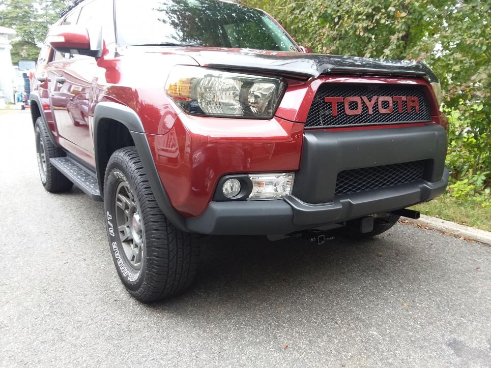

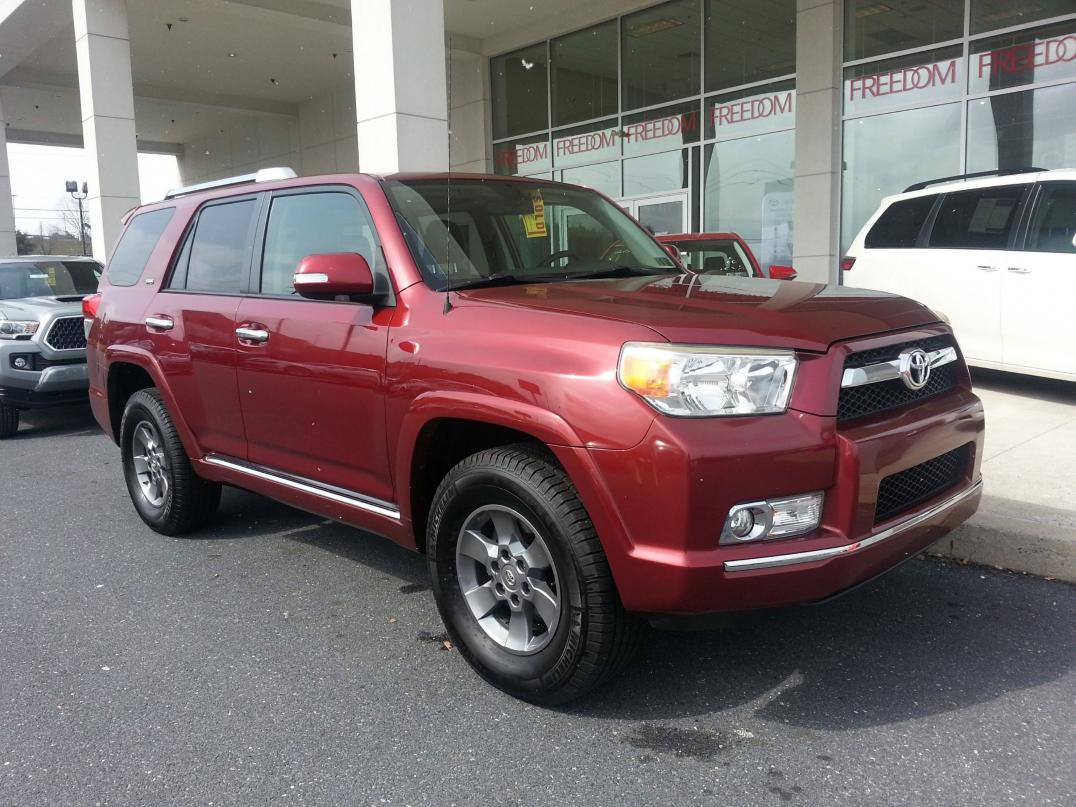

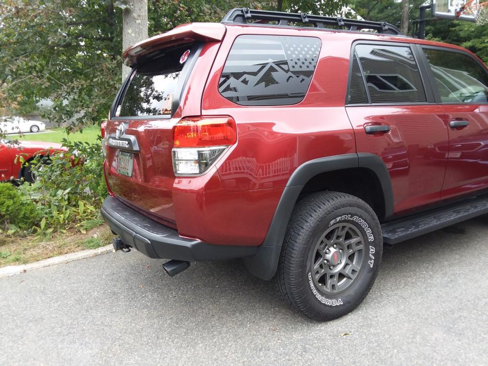

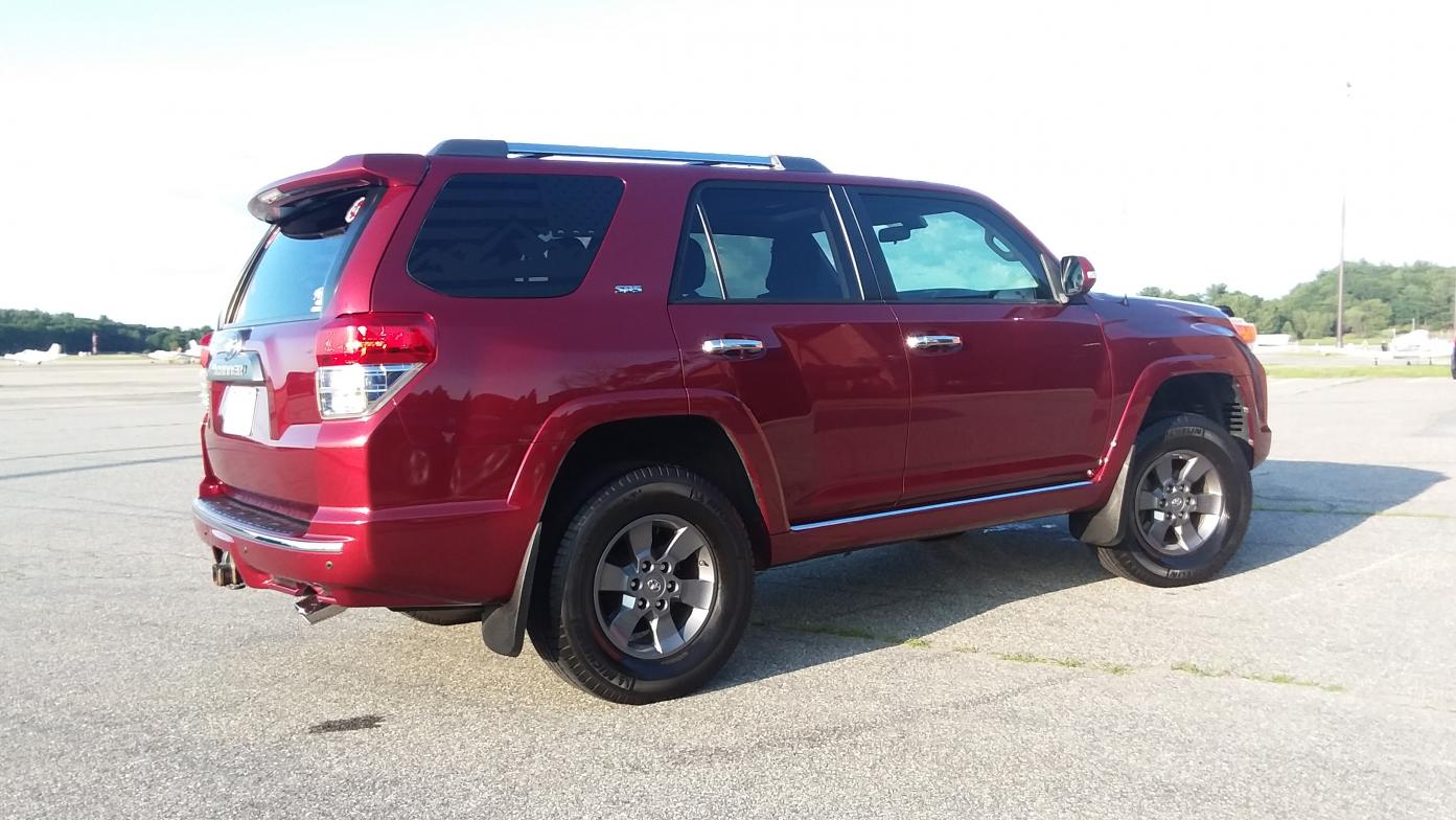

Here are a couple of pictures from shortly after I bought my SR5 and now as a cloned Trail.
The SR5 bumpers have the "ground" effects molded into the bumpers with the chrome. The does not, allows a steeper approach and departure.

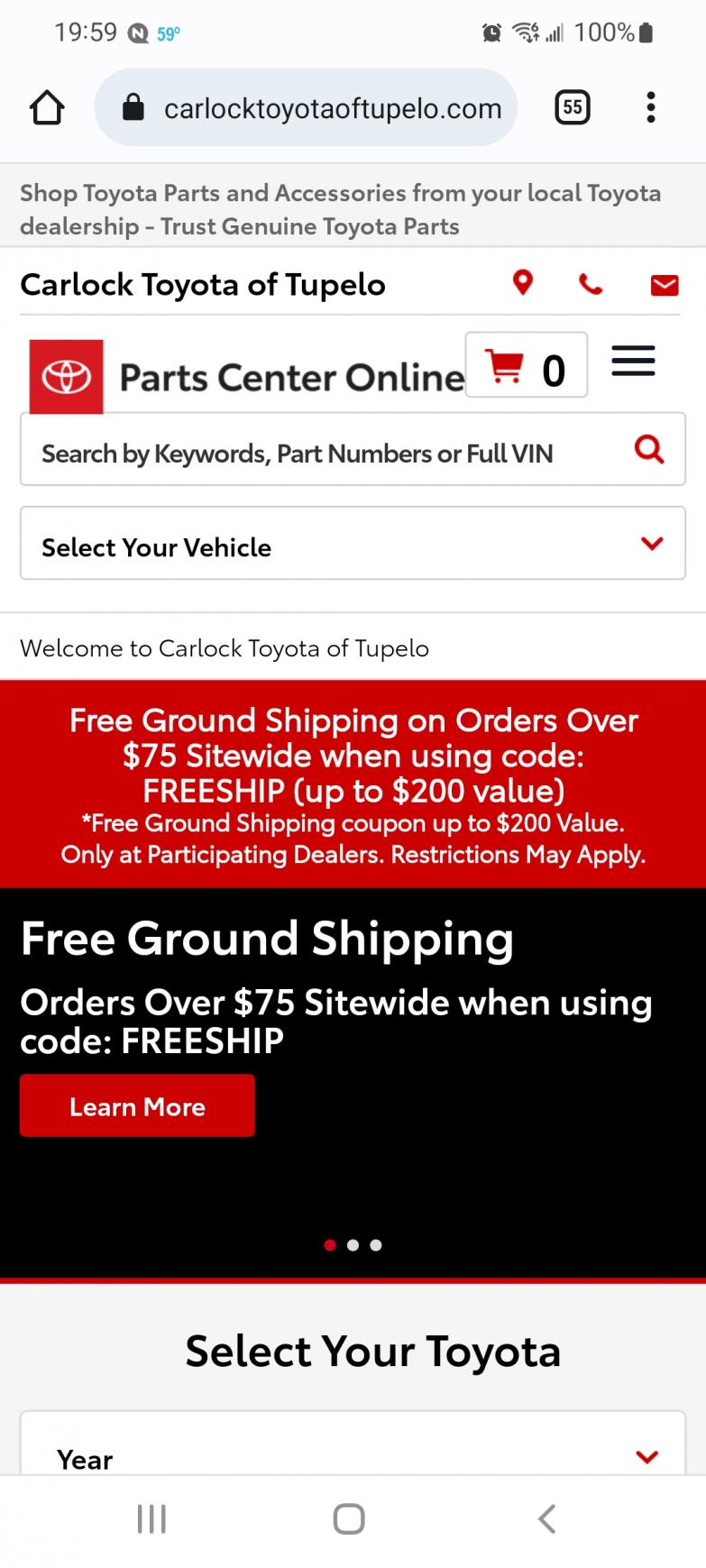

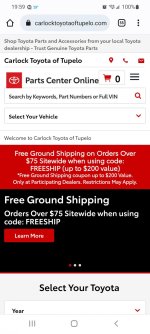

Check out the pic. For whatever reason I could not add it as a link. These guys are a parts distributor as well as a dealership.
I have ordered from them before.
Some internal bumper parts that are different are: inner fender wells, little brackets that are pop riveted to the aluminum internal bumper, just to mention a few.
